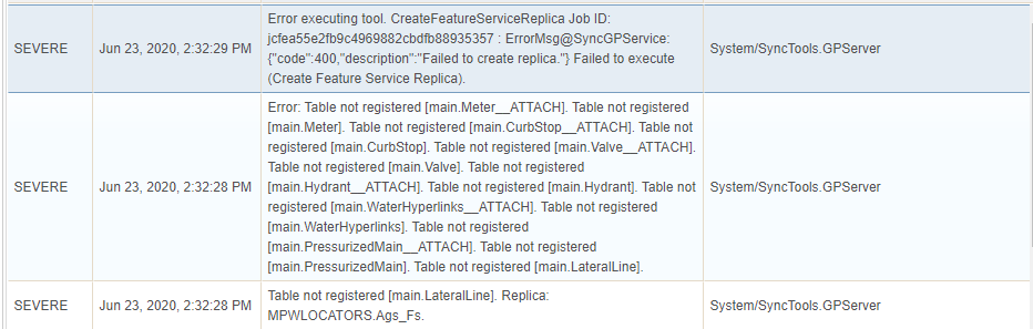

When trying to take my data offline in the New Collector for ArcGIS (Android) I continue to get these table not registered Errors:
Then the map download fails.
I am using ArcGIS server 10.5.1.  SQL server 2012 and all data is using GlobalIDs as they are just attachment tables.  All tables are in the publishing MXD.
The rest endpoint is recognizing all layers that have attachments as true.  Any ideas would be greatly appreciated for pulling this data offline.
