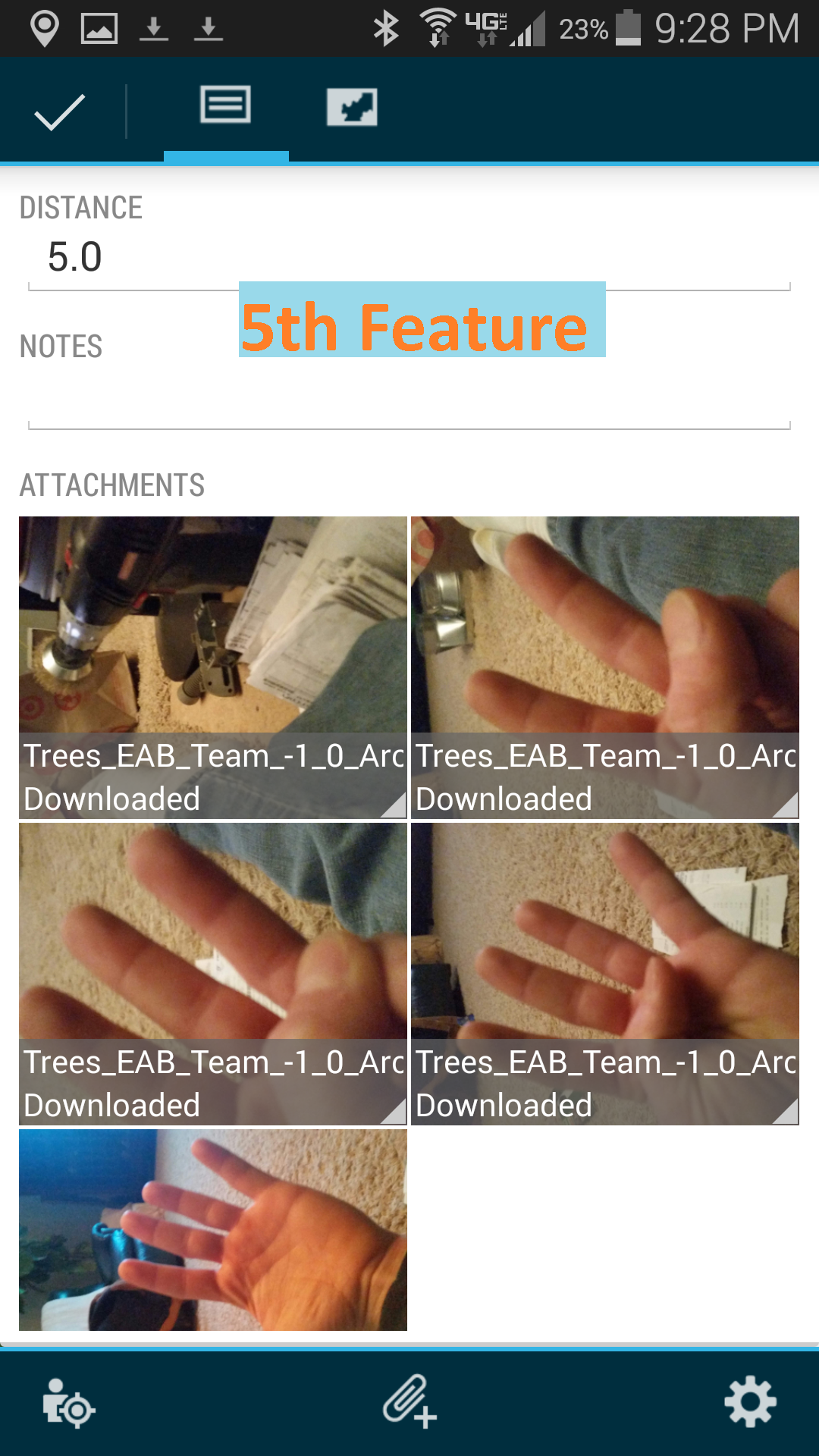

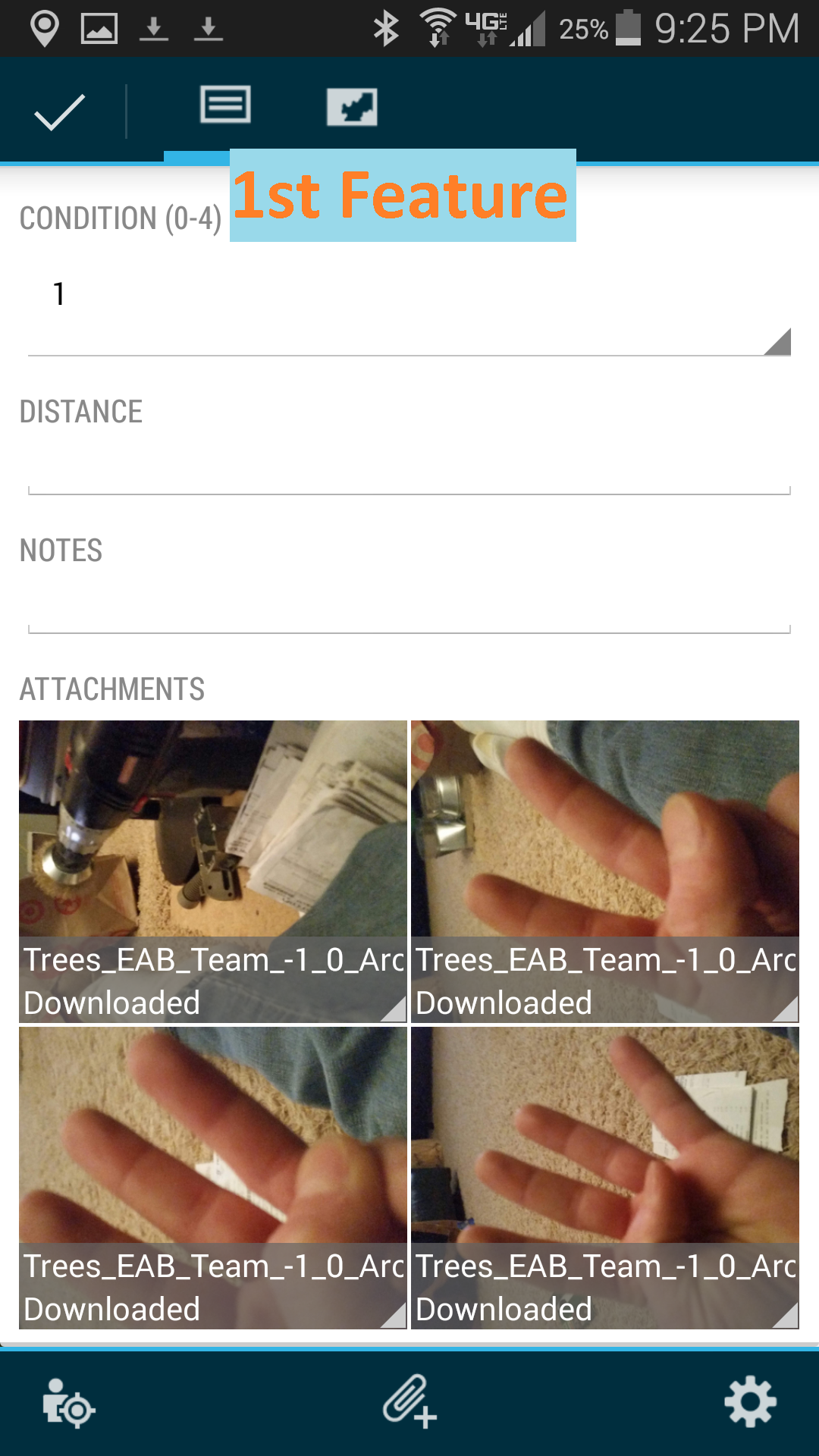

Here are images of the 1st and 5th test feature i took. for each feature i copied the previous and attached a photo via camera. but the 1st feature shows the attachments collected on the later features.

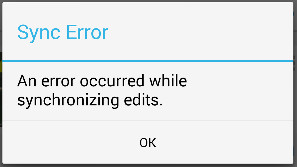

Here is what happens on the 1st sync attempt
During second attempt, the progress bar quickly moves to 99% but hangs indefinitely.

Well I solved it and this is indeed a bug. The feature service in question was republished and was given a new field for GlobalIDs. So it has a string field named "GlobalID" and an esriFieldtypeGlobalID field named "GlobalID_2". Copying features also copies the value that should be unique! This is why the first feature that is copied has the photo attachments of future features.
Perhaps other sync issues are related to this failure to generate unique IDs.
Be careful what your users copy!
