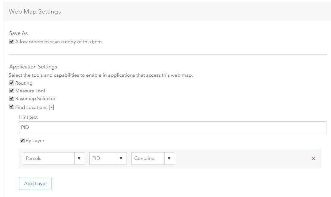

TeresaLieser
I figured out that if I had text in the hint box under Web Map Settings then Collector does not crash when trying to search!
