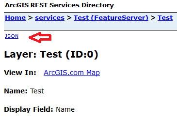

Near the top of the next page, there will be a link for the JSON that will take you to the json data.  With AGOL it looks like this:
Rest Services

In ArcGIS Server Manager I was able to click here to see the JSON
I can identify the area that needs to be updated.  "name": "0";

OK I added admin to my URL to get to the admin section
Was this
http://services.arcgis.com/xxxx/arcgis/rest/services/Layername/FeatureServer/0
Now this
http://services.arcgis.com/xxxx/arcgis/rest/admin/services/Layername/FeatureServer/0
That gets me here
I click Update Definition and I dont get anything in the box. I assume the entire JSON would be there to make edits to

On my screen, I have a link to 'All Layers and Tables' and a link to each layer between supported query formats and description.  I would then select a layer and edit its json data.  So, I'm not quite sure how your service is being hosted.
RandyBurton
MVP Alum
For your photo of "Points of Interest (ID: 0)", what is the basic format of this page's web address?  I think the admin page for this layer is where you need to be.
