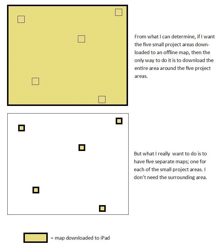

I know I can make a map available for offline use. That's not a problem. The issue is that if I want to include all five project areas in my offline map, at a zoom level that I need, the map downloaded to the iPad will be several gigabytes in size, with 99% of it being unnecessary, as it's not actually needed for my five widely-spaced, but rather small project areas.
What I really want to do is to have five separate maps - one for each of the small project areas. I don't need the area between the five project areas. But I don't see any way of doing this in Collector. When I download a map to the iPad, and then click on Manage, the only option it gives is to delete the map. What I really want to do is to copy an existing map, specify a new project area and scale for it, and save it as a new map with a different name. That way I could have five individual maps; one for each project area (Project Area 1, Project Area 2, etc.). See below for a diagram.
