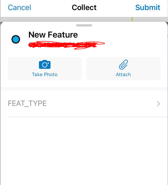

I have a series of layers with about 10 fields that need to be populated during collection. All of the layers reside in the same weblayer.
However, when trying to collect, a maximum of two fields appear. Some layers don't have any fields appear.
The only other time I have had something like this happen was when I added fields to layers I had already published to AGOL; I have not touched these since I first uploaded them. None of the fields are set to be read-only.

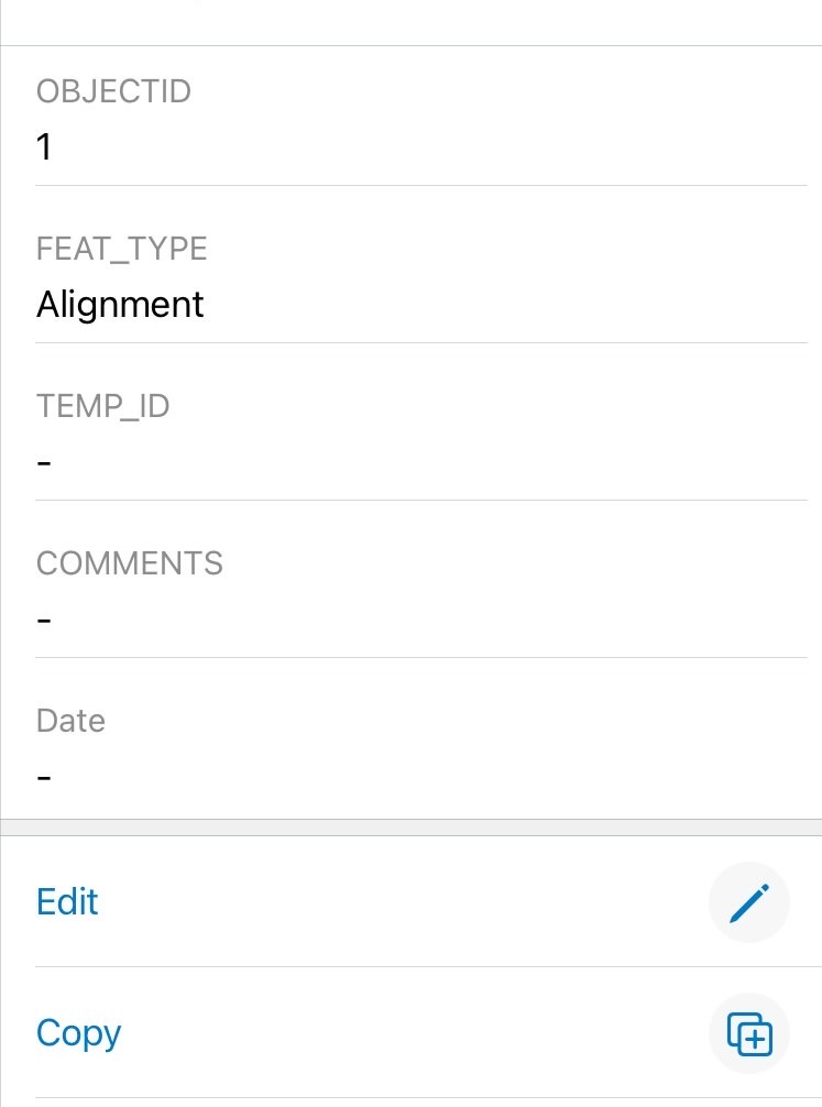

I'm sorry, I don't even know where you went to get that window. I have nothing that says "Configure Attributes" in my pop-up configuration pane. I've checked in Map Viewer and in Map Viewer Classic to make sure I'm not missing it.
Configure fields in Map Viewer just prompts me to change the alias and that's it.
Checking in the layer's item details, all the fields are set to be editable.
