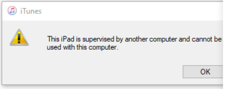

First off, yes, we attempted the workflow recommended by Esri to Access offline edits from Collector for ArcGIS directly from an Android or iOS device. This workflow has been successful for me in the past, but we were encountering access issue with the iPads that turned out to be the result of an iOS bug that could only be solved with a factory reset of the device, according to Apple support.
Since there seemed to be no way we could access the database on the device, I ended up just manually entering the points and their data into the web map. Luckily there were only 26 points on the device, so it wasn't too bad in the grand scheme of things.
