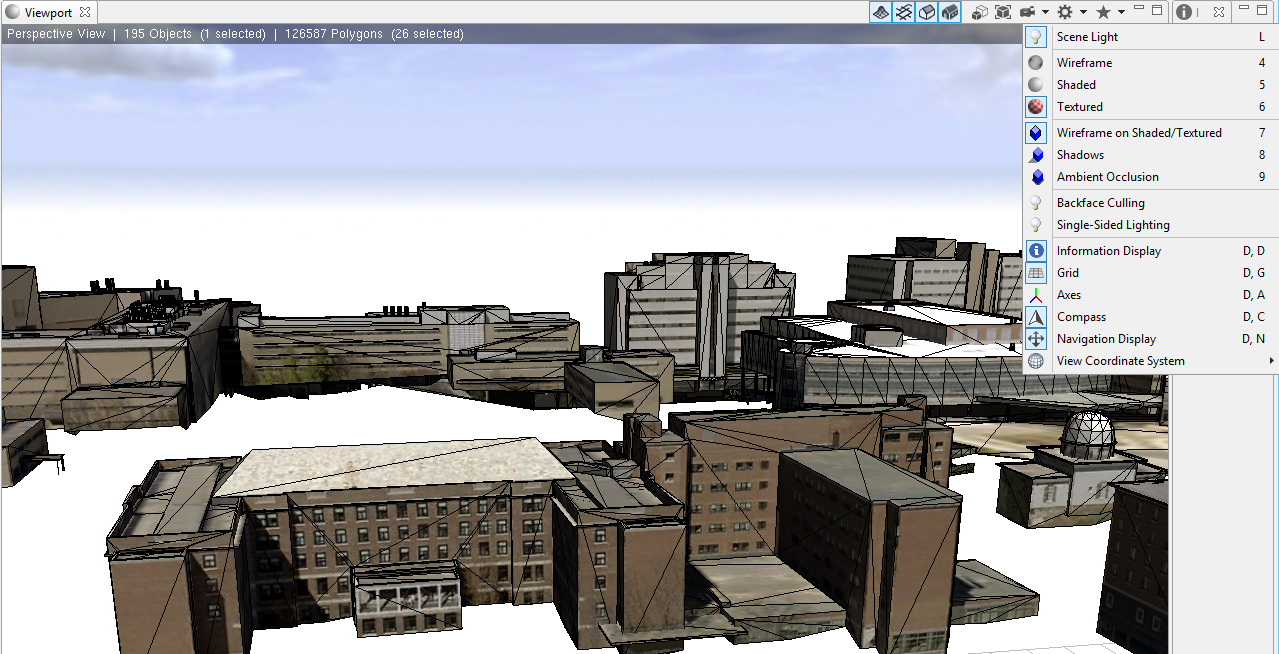

I have a Multipatch model that an outside firm created for CityEngine of our Campus Buildings.
For some reason there is a "wireframe" on the buildings in CityEngine that I cant turn off. It does not show in ArcScene even when I select the object (I was thinking maybe it was part of the geometry.)
I need to turn them off because they are horribly ugly.
In the attached image of one of the buildings the only view setting that is one is texture. If these lines are part of the texture why dont they show in ArcScene?
If I turn the wireframes on the texture on the lines that im calling the "wireframe" appear to become the true wireframe and are shown in black instead of grey.

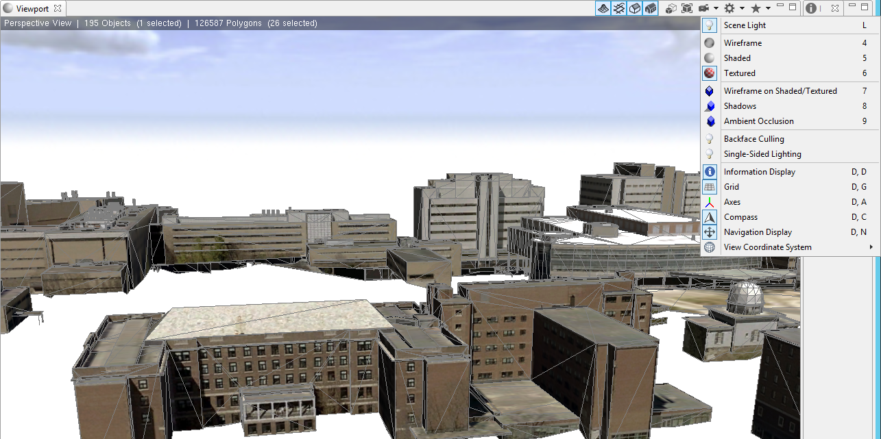

This should alleviate your problem (hopefully!).
First, make a backup of your scene.
If your buildings are part of the shapes layer, then apply the below rule (also attached).
@StartRule
Shape --> Model.
If the buildings are on the model layer then select them, and in shapes menu, do convert models to shapes, and then run the rule.
Hope this works,
Chris

Hi Jacqueline,
Two Suggestions:
1. Check to see that Shaded and Wireframe is turned off. See image below:
2.  If you are concerned that there are too many lines/ or polygons you might want to try applying a rule with a starting clean up geometry function that might help reduce the polygon count of the multipat
I hope the first one solves your problem. The settings shown there are the ones that generally control the view port in CE.

JacquelineAlessi
Thank you so much worked beautifully and exactly as described!
