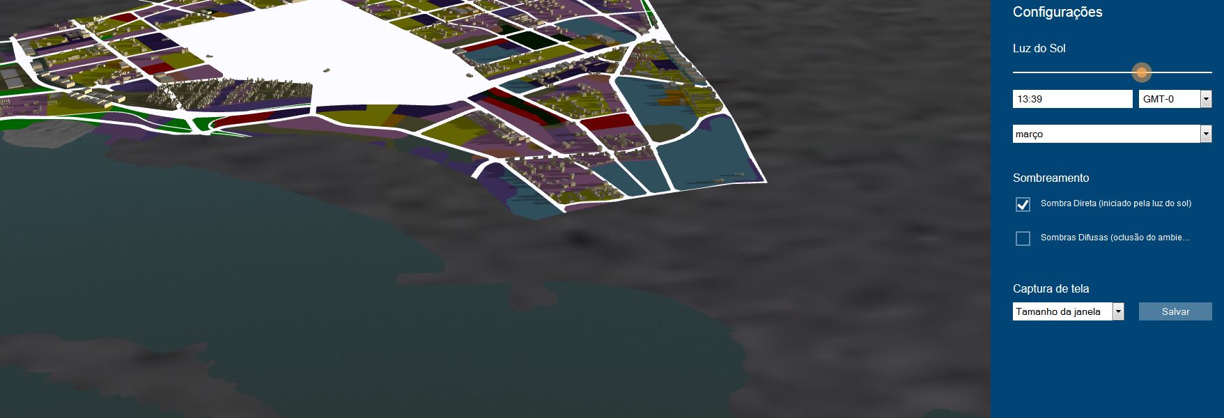

The WebScene by default open the sunlight in March and  my geographic location March is more Darkly in WebScene but on real world no (Luanda , Angola-Africa).
I tried change values in Scene Light Layer (CE),  but in WebScene the light is the same (March). The WebScene is seted for North Hemisphere?

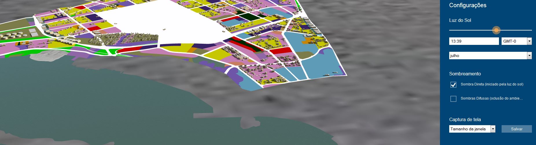

If I change in WebScene the Month for March to July, the result is perfect for my example .

Printscreen 1 - March
Printscreen 2 -  July
