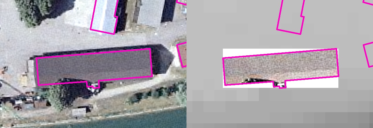

  • exporting them to GDB (multipatch) and importing them in AGP works, however the file size ends up huge - roughly 100 buildings result in almost 5GB, which I'm pretty sure is due to the basemap being saved completely for each feature
Now to the actual question
I clipped the basemap in ArcMap using the building footprints (see attached image) and would like to texture the roofs using the world-aligned clippings. I think I went through all possible projection setups and scope aligning available, is it even possible to use the textures this way?
