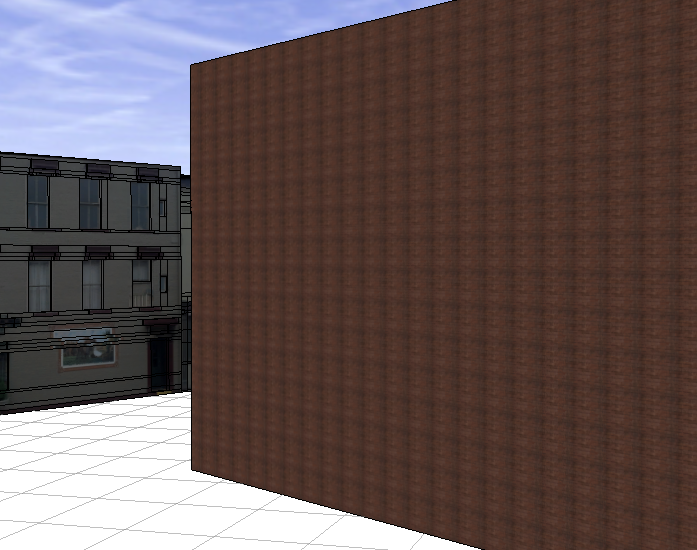

Unfortunately I can't seem to make the "seamless" part work when the building sides are large.
Attached is an example:  (disregard my facades in the background, learning Facade Wizard too!)
Here is the code that I've been playing around with.for facades and textures.
