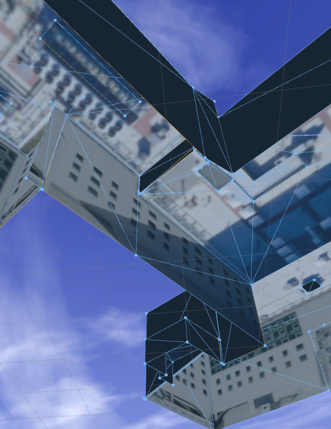

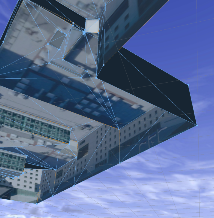

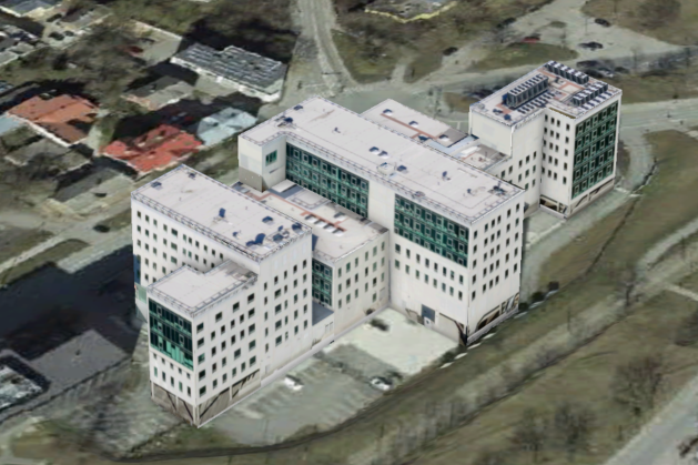

I have a building which is texturised, but when I loaded into CityEngine, the textures seem to be inside the building for some reason. How can I fix this error or is the error due to the way the buildings were texturised in the first place?
Building in CityEngine:

Building in ArcGIS Pro:

Simple answer first,  have you tried in the Shapes tab, the reverse normals option?
by Anonymous User
Not applicable
AndresKasekamp
Thanks, it worked!
