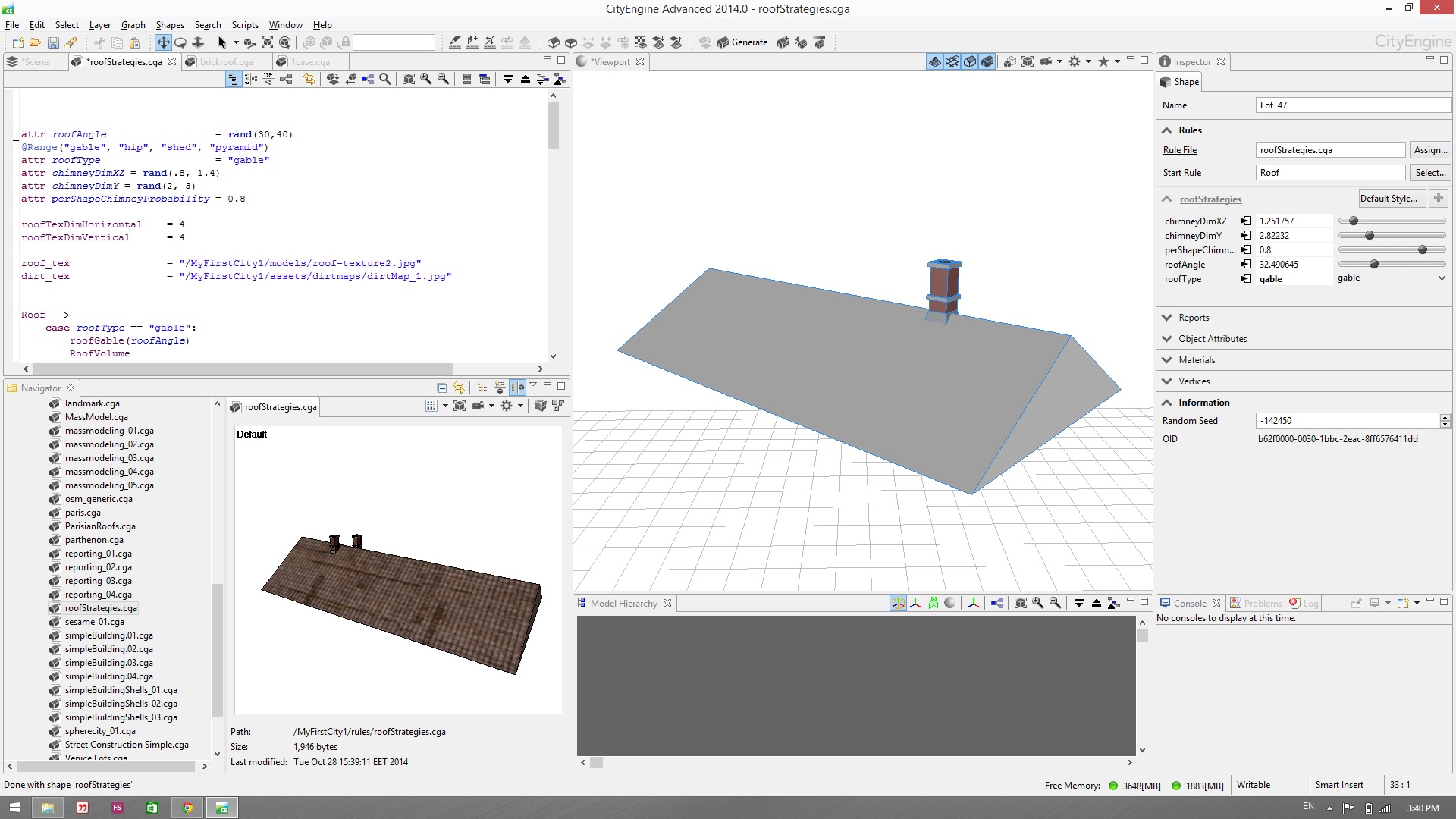

I have made some modifications to a roof rule initially intended to randomly add a chimney.
I added a texture. The weird thing is that the preview shows me the roof with the texture,
I have attached a print-screen and the rule

I put your rule into my scene, and a couple of textures in the locations  as you do. I don't encounter your problem, unfortunately.
Here's some thoughts:
- I see no version in the rule, which should cause you to have a compiler error. What version of CE are you running?
- Sometimes I've had problems trying to apply textures from anything other than the assets folder.
- You are using absolute paths to the textures, which is not a great strategy in general.
So those are just thoughts, not solutions. If you can't figure this out, I would like to see the project file if possible. Please let me know if you do or don't solve this. I'm following this discussion now.

I am using version 2014.0
So all I have to do is write in the beginning of the rule?:
version "2014.0"
Because if that is the case, it still does not work.
And to change to relative paths all I have to do is remove the project name from the path?
roof_tex= "assets/roof-texture2.jpg"
instead of
roof_tex= "MyFirstCity1/assets/roof-texture2.jpg"
I did that, no difference.
I also moved the texture to the assets folder, no difference.

Hmm. Since it worked on my machine, the next step is you dropbox me your entire project file, and I try running it on 2014.0, since I tried it on 2014.1. I would need the exact project as it stands so that when it is opened, it shows the building in question. No services except dropbox please. Let me know.

I don't know what the issues was.
When I applied the rule to another footprint (another shape file), it worked.
Even though I initially applied the rule to a shape from one of the tutorials.
Thanks for the help:)
