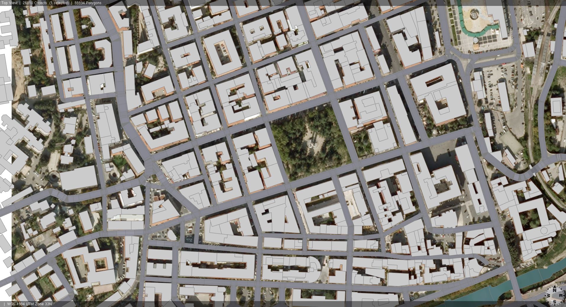

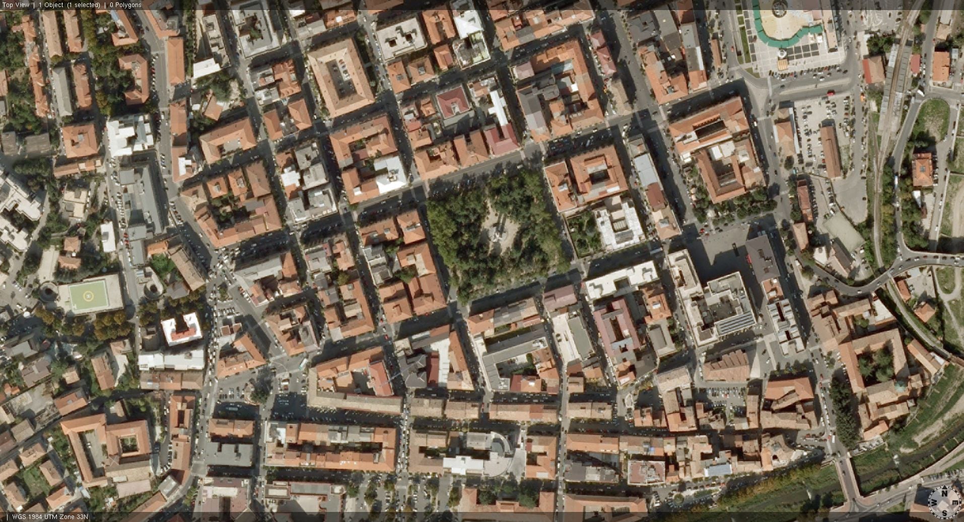

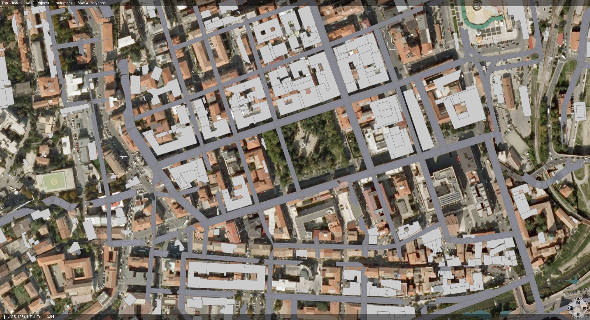

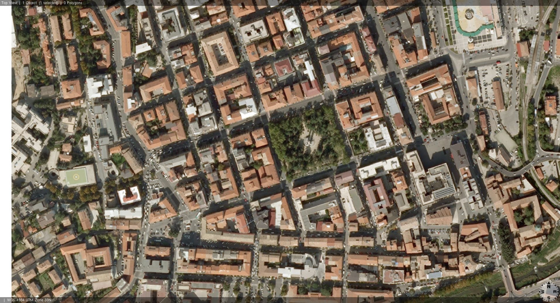

Hi all,
I created the terrain with height map with tiff images, but the texture is located in wrong position. I posted some screenshots to show my issue.
In the first 2 images I created the terrain (Terrain Import) with greyscale tiff for heightmap and set the aerial view as texture. As you can see, the texture is not properly aligned with the buildings and roads position.
In the second 2 images I created a flat terrain (Texture Import) using the same aerial view image, and it is in perfect position with buildings and streets.
Any suggestion? How can I change the texture mapping?
Please help me!
I add one of the images I was talking about with the heightmap.

MatthiasBuehler
Deactivated User
Well, if you drag-n-drop either of the images into the viewport in CE, the terrain creation dialog will come up.
Best do this in a new scene, for both image files.
If the propoposed scene coordinate system (SCS) and the extent/offset don't exaclty match for BOTH images, the georeferencing info is wrong.
What you then can do, e.g. if one of the files does not have a proper georef definition or e.g. does not recognize a projection, therefore falls back to metric scene coordinates, use the one that has proper georeferencing data, CREATE the terrain and then edit the texture file in the terrain object. The reason for this is that when you're still in the terrain creation wizard, loading a new map will reset the extent in the wizard. If the terrain is created, loading a new picture will only edit the picture.
But the images MUST MUST MUST depict the same extent, since basically BOTH of the textures are only 'draped' on top of the terrain geometry (scaled to the ends in both dimensions). The georef info is only used to create the terrain geometry, the images are then mapped over this geometry, even if the extents don't match. So be very cautious.
Ok?

MatthiasBuehler
Deactivated User
Hi Valerio,
Did you create the terrain image in ArcGIS? If so, does the terrain line up there?
Does the image have the exact same projection as the other data?
To fix this quick and dirty, select the later, press 'w' and move it into position. Of course, you want to have a proper solution.
