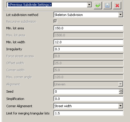

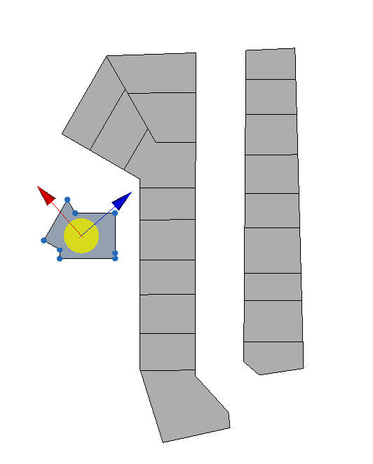

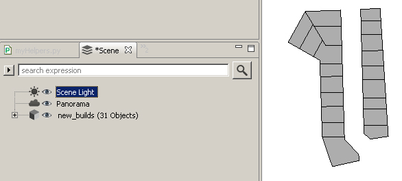

Result - 31 objects, however visual count suggests there should only be 20 - see image.footprint count.jpg
It appears that some footprints have been duplicates - see image duplicate.jpg
