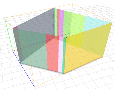

To isolate the orientation problem I have made a simple shape where I try to apply SplitRecursive for each side face. Seems not possible to attach a scene here so I give the shape vertices instead. I have tried various kind of alignScope but without success.
@StartRule
Init -->
	comp(f) {side: SplitRecursive | all: NIL}
Here is the current result. In this simple example I expect one Rectangle for each face.
ThomasFuchs
The approach only works for horizontal and planar Shapes like building footprints. The axis of pivot and scope must be aligned.
Generally, rectangles can be created with the innerRectangle operation.
MagnusLundevall
Oh, what a pitty. And there is no way to align the scope such that it can work?
I read about innerRectangle but don't see how it can be used to solve the example in the first post. Can you?
