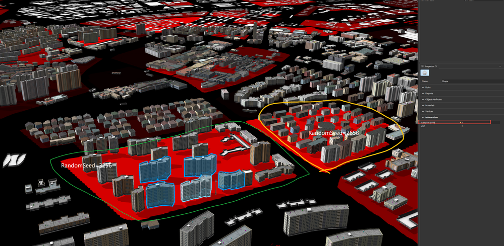

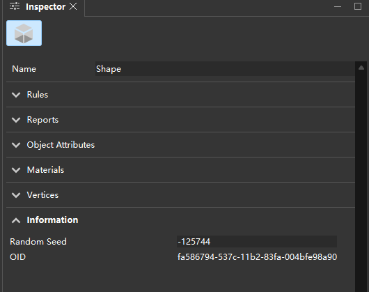

I hope to specify the value of RandomSeed in the cga. I have tried to assign values to seedian and rand, but found that neither of them can cover the global random value.企业微信截图_20250815105631.png企业微信截图_20250815105538.png

I created fixed random values for each shape within the region. I hope to use these values to overwrite RandomSeed to maintain their consistency.企业微信截图_17552271485496.png

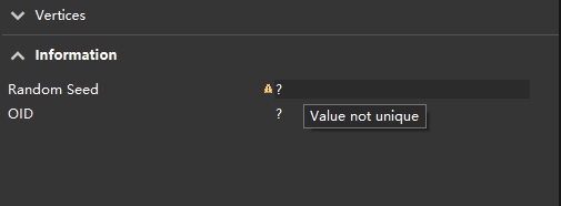

企业微信截图_20250904105630.pngIt cannot change this value.
JonasObertuefer
You can't change any inspector values including the Random Seed from CGA. If you you wish to set it to a certain value you can do it in the Inspector by editing the value in the input field directly or you use python with ce.setSeed()
