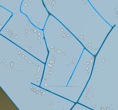

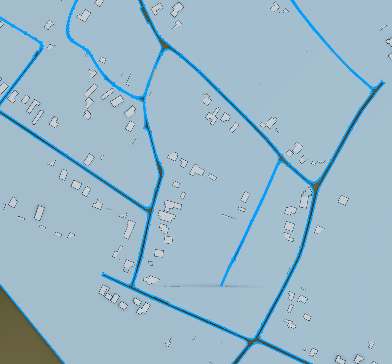

I have a file with land use and building footprints. I have gotten to the point in python of selecting all the land use shps from the object attributes. In this picture:
I have written code that has selected everything tagged as residential in the object attributes.

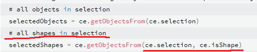

desert
I have referred to the link below.
getObjectsFrom
change
shapes = getObjectsFrom(ce.scene)
to
shapes = getObjectsFrom(ce.selection, ce.isShape)
I hope this helps.
