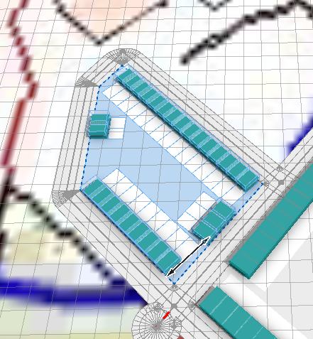

  1. The orientation/ shape/continuity of the initial surface seems to matter quite a bit in Puma.khakharKhakhar_0-1669799131163.png
image1257×1073 116 KB
Im using the Complete Streets:Street Start Rule Package as RPK in Puma. I wonder if there is a way to resolve this within the attributes somewhere. Or would that require a tweaking of the RPK in city engine?
  1. In CE, the rule is implemented on an input road centreline. However, in Puma, the initial geometry requires a surface or a closed polyline. Is that intentionally set within the plugin or could that be modified as well by changing the code?
Any response is much appreciated.
Sid

ThomasFuchs
Hello Sid
Thank you for your question about using the Complete Streets:Street Start Rule Package as RPK in Puma.
Currently, Puma doesn't support other geometry than flat polygons. It means that the rules like the complete street have to be modified a bit to work with Puma.
This was already done for the showcase scene for the Puma release, and all the rules used in this scene are available to download here: https://esri.github.io/cityengine/puma#examples
Alternatively, you can also modify a rule to work with Puma using the CGA Editor in CityEngine, in a similar way.
khakharKhakhar
Thanks, Thomas.
I understand. I already went through all the showcase files used in Puma's release and found that the streets and sidewalks RPK only uses flat polygons, hence the question.
Perhaps I should look into modifying the rule in CGA editor to work with Puma. Although, that'll be a whole new territory for me to explore. Let's see how that goes. Thanks anyway!

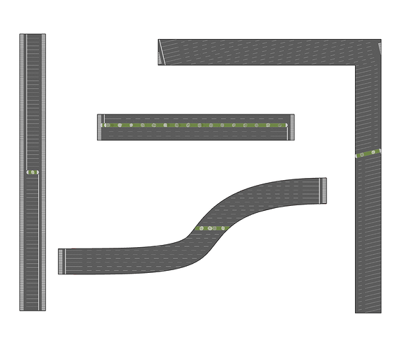

RomainBigare
Hi Thomas,
Apologies for reviving this thread - but by "flat polygons" do you also mean rectangular ones ?
I have been comparing results applied in CityEngine and results applied in Puma on the same irreguar shape, and they vary quite a bit. It seems Puma has a hard time working with non-rectangular shapes. Is there anything I can do to work around this ?
Expected result, from CityEngine :
Expected result, in CityEngineExpected result, in CityEngine
Result in Puma :
Wrong result in PumaWrong result in Puma
JonasObertuefer
Hi,
This is a bug in the current release of Puma. Until this is fixed you can add a cleanupGeometry() at the very start of of your StartRule:
// Your start rule
Init -->
    cleanupGeometry(edges, 0)
    // continue here with your normal code
Let me know if this works for you!
