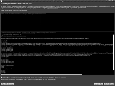

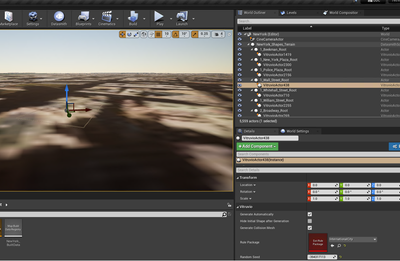

Here are 2 screenshots. 1 showing the crash report when I try modifying any of the placed Vitruvio Actors and the second screenshot shows what the details panel looks like and you can see the Vitruvio Component section is missing under neath the transforms section
I am using the New York example project and when I play my scene here it generates the models and shows the buildings no problem

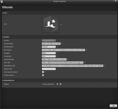

 Do these plugin properties look correct? The project is a fresh install of the Paris Example Project
