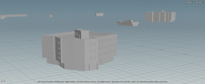

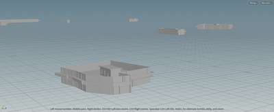

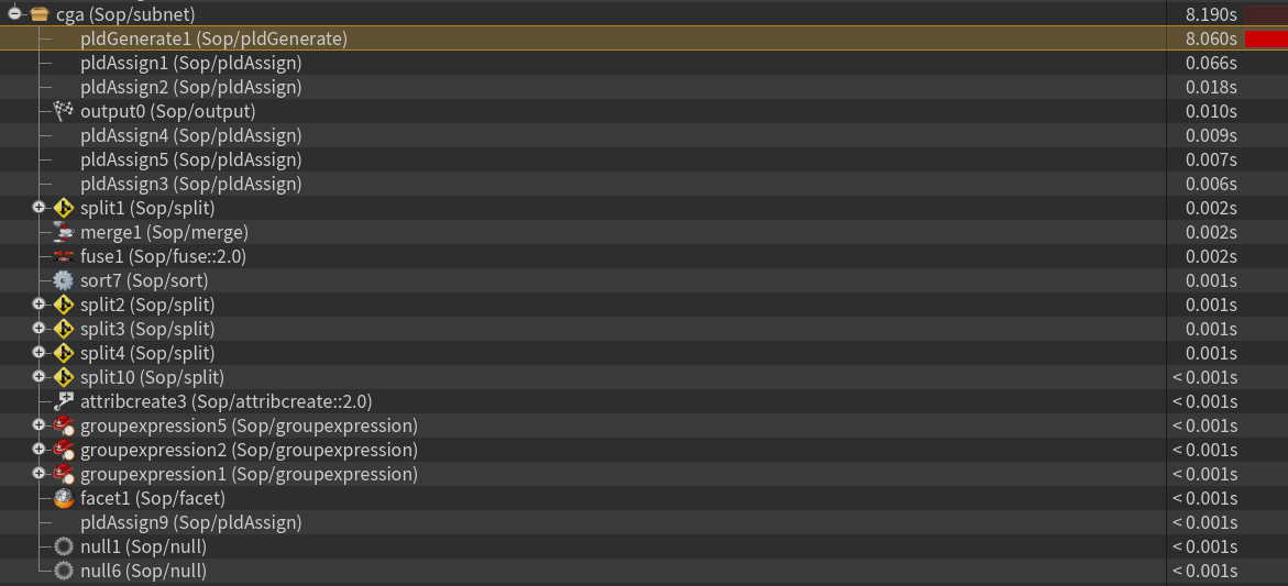

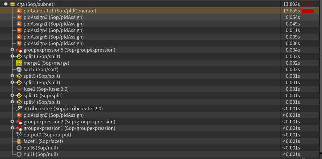

Hello, during the use process, I found that there is a significant performance difference between Palladio version 1.7 and version 2.0. I opened the same file to test the build speed, and their information is shown in the following figure. Is it possible to obtain the performance of version 1.7 on the new version

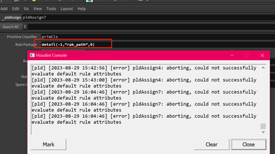

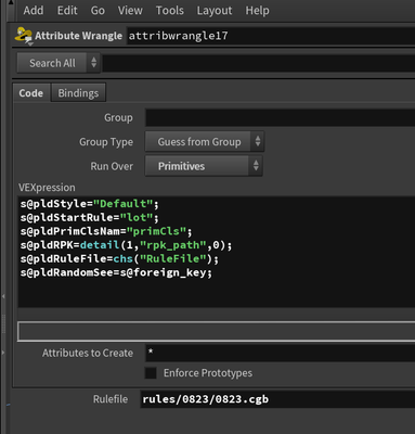

In order to use path variability, I used attribute nodes myself to replace the pldAssign node, but its height did not take effect

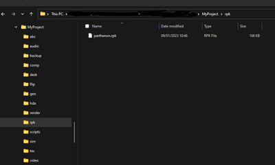

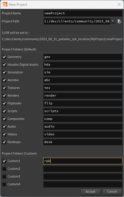

1. Create project with rpk subdir

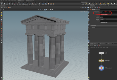

2. Copy your RPKs into it:
3. Assuming you store your hip files in the project root, you can then reference the RPKs with the $HIP variable:

Regarding performance, I did some initial tests (25 buildings with ~20mio polygons):
  • Palladio 1.7 in Houdini 18.0: 6.1s
  • Palladio 2.0 in Houdini 19.5: 5.8s
So we cannot yet see worse perf in Palladio 2.0.
Would you mind sharing some of your scene parameters, for example:
  • How many initial shapes do you have?
  • How complex are your rules, e.g. how many attributes do you have?
  • Do you use inter-occlusion (between models)?
  • How many assets do the rules insert?
  • How many textures do you use?
Ideally, if you could share an example scene where you see the perf difference would be best!
biaozeng
I constructed a relative path, but this node doesn't seem to support it
I hope this helps!
