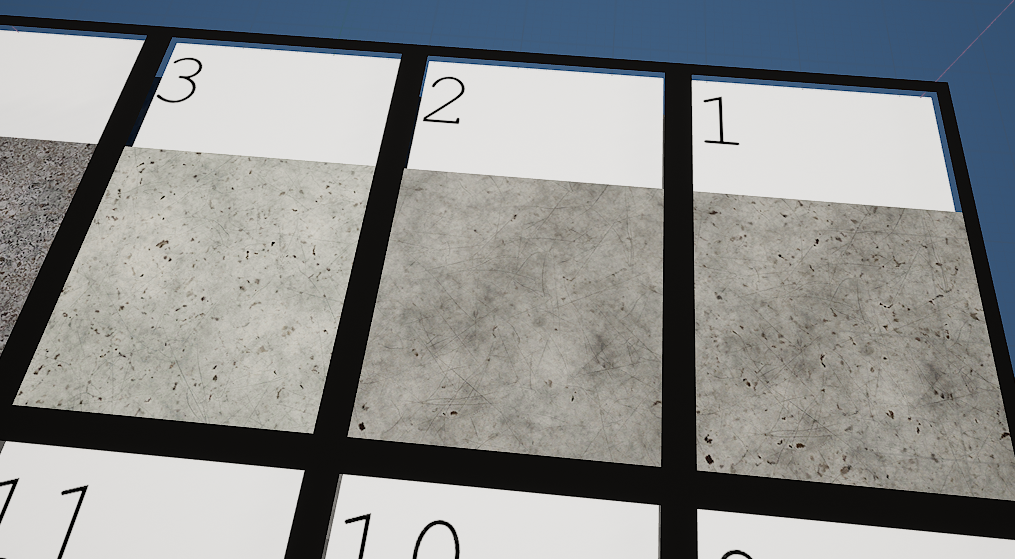

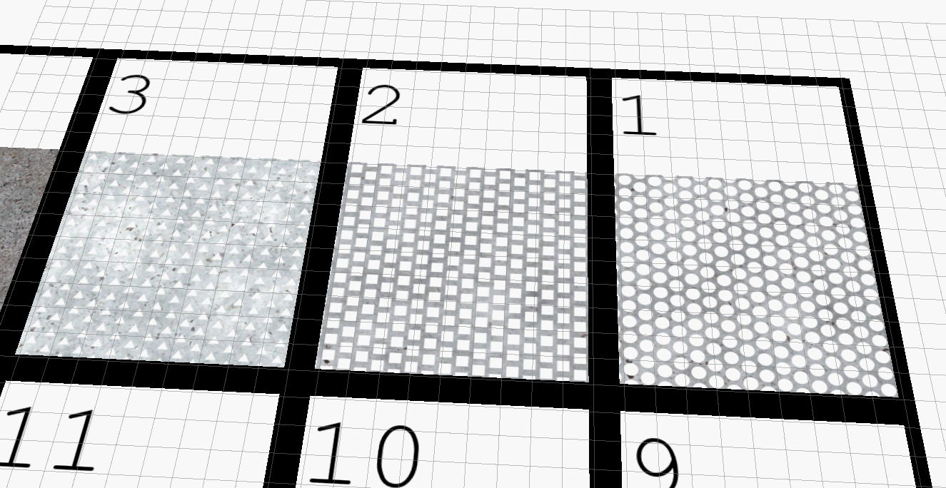

Hi, I wanted to figure out how the PBR materials works, with maps was included etc. and how to get automate the assignment of a material catalog with PBR materials.
So my first question, why is my export not honoring opacitymap, how should the CGA look to get the opcatiymap included? In CE it looks as it should, but export to FBX or DATASMITH, I just get a full metal plate
What is the trick, that I've never figured out? I know that we did something with the template Unreal project and the rule, but as I understand, that should not be needed anymore.

First about the opacity thing. With CityEngine 2019.1 (which one are you using?) the Unreal export should automatically choose the right "opacity mode" for you, so you actually should not need to do anything special in CGA.
But, if you are setting material.shader to some shader path in Unreal (like "/Game/Materials/CityEngineMaterials/M_CE_Opaque") or you set the opacitymap.mode to opaque the automatic opacity mode selection is not triggered anymore.
If you think you did everything right you can also send me a zip of your project so I can have a look
