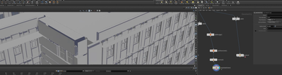

All points are split

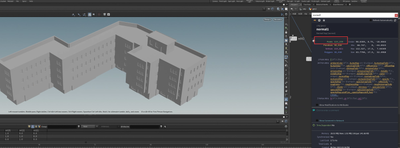

SimonHaegler
A quick investigation showed that this is happening because all vertex attributes include vertex normals currently share one index. If you would enable shared/smooth vertex normals, the faces should have shared points.
I've logged an issue for improvement: https://github.com/Esri/palladio/issues/200
