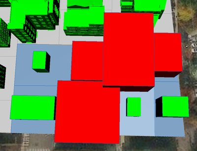

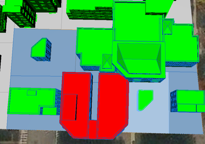

I'm switching LOD by user-created attribute
I found that
Test --> case overlaps(all) : Red
else : Green
Red --> color(1,0,0)
Green --> color(0,1,0)
occlusion detection on bounding box (which is still box OBJ files) works great

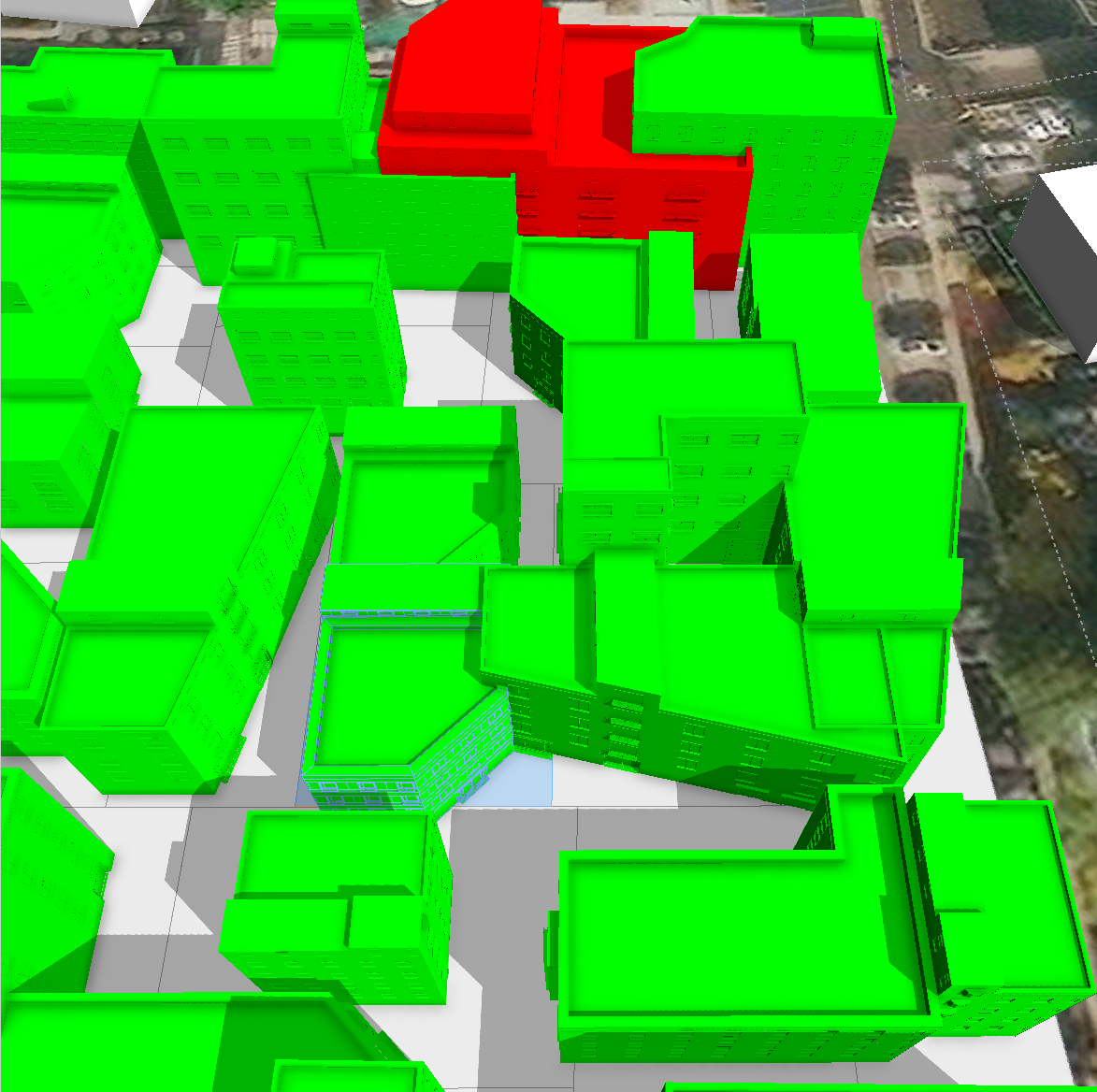

but not with high-poly OBJ like img below
It only detects if model touches street
JonasObertuefer
Hi @GunSikKim,
Quoting from the inside / overlaps / touches function cga reference:
In any case, tests are only performed against geometries which form a closed surface (i.e. a waterproof mesh which has no boundary edges).
So you need to simplify your inserted buildings first somehow. One possible solution would be to create a footprint out of the imported building, extrude the footprint and then do the occlusion query:
