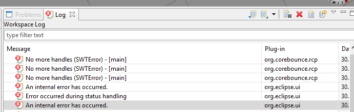

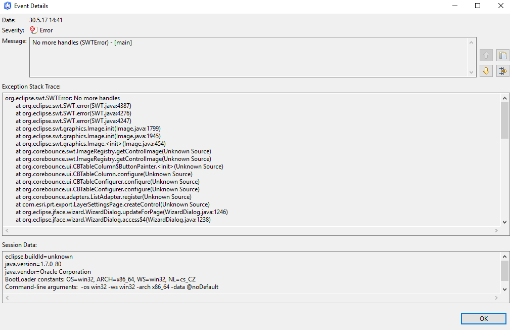

Hello,
I am processing large number of .gdb files the following way:
  1. load 500 .gdb objects in CE
  2. process these 500 objects
  3. export them as .gdb
  4. repeat
during this process, CE briefly displays and closes import and export gdb dialog windows as it should but after few iterations (the above process is repeated ~500 times) It hangs up on one of these dialog windows and the script stops, UI freezes thus CE is irresponsible and I can't do anything with it other than close it. When I restart it, everything works as it should after I run the script again and it does another 500 iterations..
the problem that it displays is on the following screenshots - I am unable to post .logs of all the errors because UI is frozen at this state so I cannot open "save log" dialog window but I migh be able to make screenshots of all of them if it is necesarry:
I was searching about this "no more handles SWT error" and found out that it's a common eclipse bug that has something to do with limited number of handles that OS provides to eclipse and when these handles run out an error occours or maybe it's a memory problem but I have 32GB and CE only uses 9GB
Maybe this is not CE-related bug and more like Eclipse-related but I would like to ask if anybody has any idea how to fix it or workaround:
Possible solutions that I can think of:
  1. increase number of handles that OS provides somehow (maybe edit something in CityEngine.ini)
  2. make CE cleanup itself after some iterations (~400) by using some python code (maybe run garbage collector etc..)
  3. force CE to close after some iterations (~400)  and then start again and continue where it left - and repeat - this can work - I can restart CE but I don't know how to force it to run a specific script after startup
any help is appreciated

MarekDekys
Hi,
I was working with 2016.1 in that time. Now, when 2017.0. (final, non-beta) came out, I tested it again and I believe I have same (or similiar) error:
this error happens while exporting meshes of very large area into small tiles in .obj format. No more handles (SWT Error) occoured after around 10k exports (maybe this is the max limit of handles that OS provides to CE)
The problem is that the entire area has about 90k tiles - so 90k exports for one layer. If we export several layers for one small tile, by multiplying this number, we can end up having about 500k exports in total. which means restarting it for 50times or more depending where the automatic process stopped working which can take weeks.
Is there any way to solve this? maybe increase the number of handles for CE or to decrease handle usage?
below is the error log (I changed the long path of our original python script location to C:\python_script.py for better readability):
