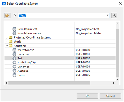

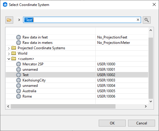

Hello,
I'm currently trying to generate a city model from an OSM map, and I want the 3D model to align with my other geographic data. To achieve this, I've been using a projection file(.prj) to add a custom coordinate system.
However, I've noticed that if two projection files describe geographic locations that are very close together, CityEngine doesn't allow me to add a custom coordinate system. Therefore, I'd like to ask how I can delete a custom coordinate system that I've already added, or if there are other methods to address the issue I'm currently facing. Thank you.

Thanks for your question. Usually, it is not necessary to remove user coordinate systems. If you still want to do it, modify the CityEngine_User_Projections.xml configuration file. It resides in the <user>/AppData/Local/Temp/ Folder.
