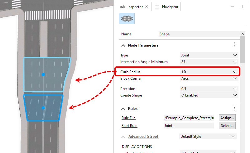

Hello everybody,
Does anyone have a suggestion on how to elongate the transition of a widening road? Also, is there a quick way to increase the curb / turning radius? The attempts I have tried are not yielding the results I was hoping for.

Hello @ChrisKo3
Thanks for reaching out with your question! That's a tricky one, indeed.
When dealing with such challenges, you could gradually increase the Segment Width by partitioning the segment. In case of asymmetric lane distributions, as in this example, also adjust the Segment Offset. To smoothen out the transition in the Joint Nodes, set the Curb Radius to the max value of 10.
