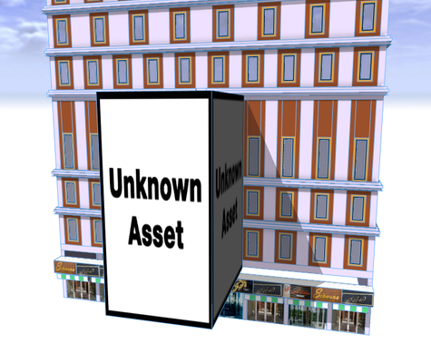

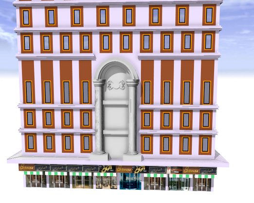

Hi every one .when i export the cga rule to rpk rule the obj model it not work .How can I fix this problem?
cga rule file is applied in this modelcga rule file is applied in this model
In this model, the cga rule file is applied as rpkIn this model, the cga rule file is applied as rpk

Hello @Farhan
Thanks for your question. When creating the RPK please make sure the asset is included in the package. If not, it is possible to manually add the OBJ and its dependencies (.mtl) in the dialog:
