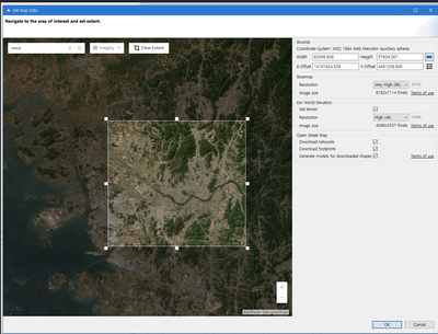

when I'm importing somewhat large scale area,
It always ended up not importing footprints and 3d viewport doesn't show anything
(importing Seoul area)
leaving all the options as default

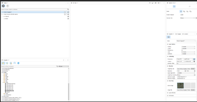

nothing in viewport, no footprints

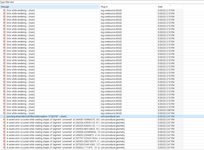

I see bunch of errors in the logs
JonasObertuefer
Hi @GunSikKim,
Thanks for the screenshot of the log. I was also able to reproduce it on my machine. It happens only for the street network import. It seems CE has a problem with very large networks. We will look into it.
So what can you do in the meantime?
  • If you don't need streets you can simply uncheck "Download networks" in the dialog
  • If you need streets you need to do seperate downloads for them with a smaller extend (or multiple smaller downloads) The downside of this is that you will end up with multiple seperate street networks which are not connected.

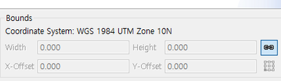

also, putting numbers in coordinate system for tiled work doesn't give you exact the same region in other scene file.
This is because for a fresh scene file there is no coordinate system defined by default. so the dialog uses Web Mercator and after the first download the coordinate system will be set to UTM (as in your screenshot). The workaround is to either predefine the coordinate system in your scene (Edit -> Settings -> Scene) or do an initial GMD download first which you actually don't really need (e.g. get an 1k basemap/terrain for a large extend of your region)
