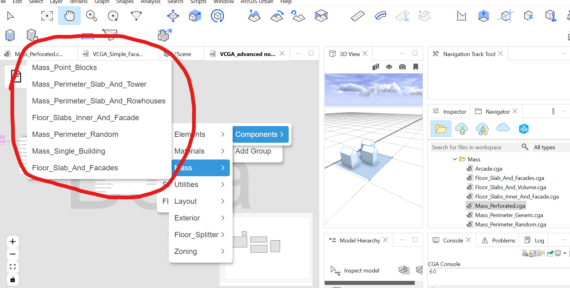

Hello everybody
I am using city engine 2023.1 and when I want to add some node(components) in my VCGA based on the tutorial that ESRI has been uploaded in You tube I can't see the whole list no matter where I click on my VCGA screen. its just like my screen is too small for the list but it doesn't make any difference when I zoom out. I attached my screen shot to this post. can anyone help me on this? Screenshot 2024-01-23 130709.png
AlessiaPaccagnella
Hi @ParisaZhaleh!
Thank you for your question.
Yes, that's a known issue of the Beta, we are working on improving this.
As an alternative, you can open the search bar (double click on canvas) and create the nodes from there 😊
