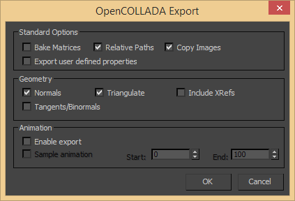

But I suggest to first import the Revit FBX into 3D Studio Max using the "Autodesk Architectural" preset
And then export it to Open Collada.
