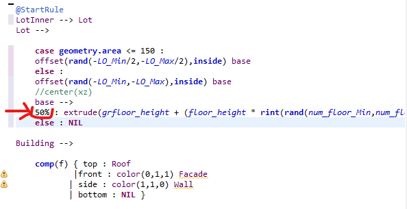

how to control % as a variable?

Hi everyone, I'm new to Cityengine, I'm trying to create my first ruler file and I'm wondering how to control a % value? Please see attached picture. Thank you for everyone.Screenshot 2023-05-29 223522.pngScreenshot 2023-05-29 223522.png

//use the p() function probability for true in [0,1], instead of percentages
attr my_prob=0.5
base-->
case p(my_prob): X //true
else :Y  //false

trungta
Thank you very much, your solution has solved my problem
