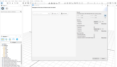

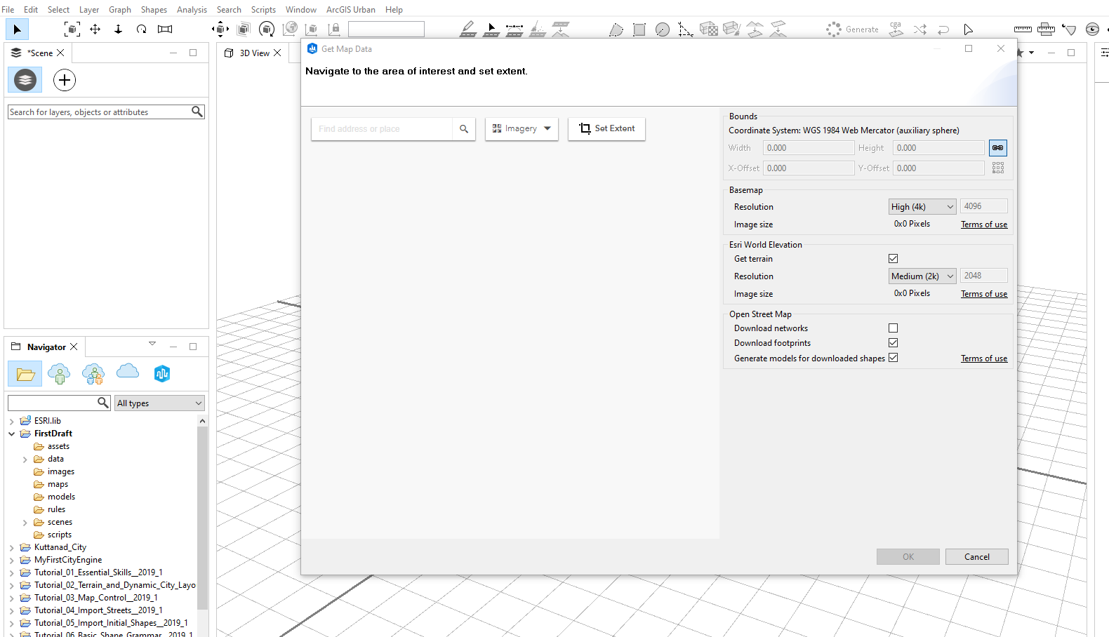

Dear Community,
Can someone help me with this query please? I'm trying to create a scene with the Map in City Engine (2019.1) but the Get Map Data window is empty. Is there a problem with my version? I'm using CityEngine on my university campus computer.
Thanks in advance
JonasObertuefer
Hi @RupaLNU,
Get Map Data does not work anymore in CityEngine 2020.0 and older. You need to update to version 2020.1 or newer.
See also this post for some more information.
Best,
Jonas
