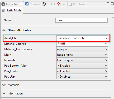

  1. Can you preview the asset '/Example_Pompeii__2014_0/data/Bridge fixed.obj' in the Navigator?
  2. Have you tried both drag and drop and "RMB/Import..."?
  3. Please check the assets workspace path in the inspector. 2016-07-12 14_52_23-CityEngine Advanced 2016.1 - Pompeii.cej.png
I hope this helps you find a better solution.

Ok, thanks Thomas. Moving the object/dae one level down to /data did the trick. Now it works as expected!
