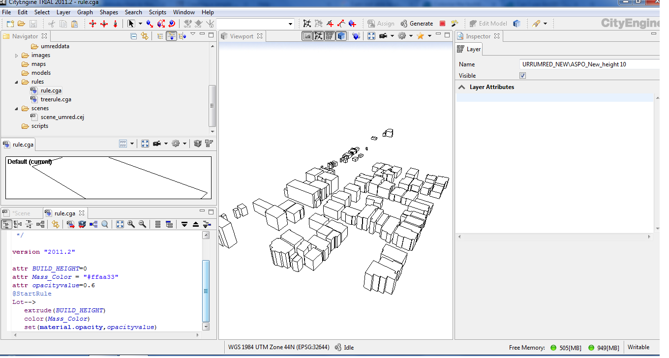

I am new to City Engine and using trial version 2011.2.I want to know how the colors are given to buildings?pic.png
Cga rule file for buildings I have written is :-
version "2011.2"
attr BUILD_HEIGHT=0
attr Mass_Color = "#ffaa33"
attr opacityvalue=0.6
@StartRule
Lot-->
   extrude(BUILD_HEIGHT)
   color(Mass_Color)
   set(material.opacity,opacityvalue)
Is there something I am doing wrong or missing ?

Hello Mansi Mittal,
Your CGA code will work just fine with version 2014.1 and above.
Please refrain from using an old version when evaluating CityEngine.
A free trial of CityEngine 2016 is available on Esri CityEngine | Try CityEngine Free
Your workflows will certainly benefit from newly introduced features like:

Your CGA is correct - I'd suspect that the old program version's the culprit here. Maybe try color(1,0,0) instead of hex.
mansimittal1
Still colors are not showing up.

mansimittal1
I got it.Thanks for the help!
