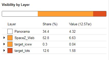

Hello,
I am trying to generate a report from a viewdome analysis result (values in Visibility by Layer). Is it currently possible to extract this information in report?
I tried to apply report rule in cga, but was not able to apply it in this analysis layer.

Thank you for your response. so I assume that it is the same for other analysis layers -  no report available for view corridor and veiwshed. However, is there anyway to export that result into external files directly such as csv?

There is 2 ways to do this:
  1. In the Inspector highlight the table with the visibility information, then copy paste into a spreadsheet
  2. Use Python to query the information and write it out to a .csv file, see: Python Scripting Command Reference
