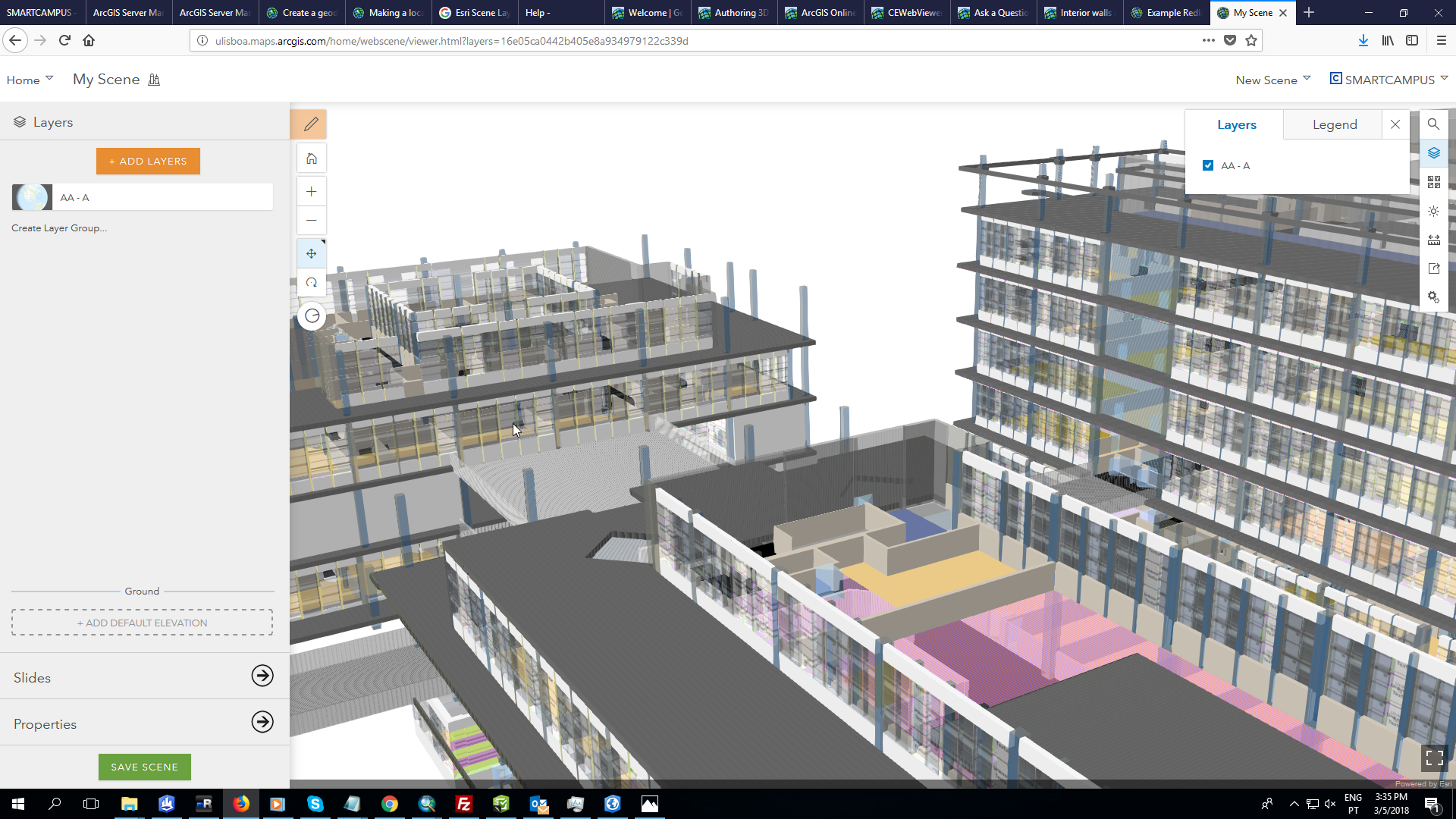

3ws files works very well, but I want to create 3D Webscenes on my Portal (not on AGOL). My workflow:
 - Create my project on CityEngine
 - Select my Data on Viewport and Export Models > ESRI Service Layer Package (slpk).
 - Open my Portal > Content
 - Add data from my Computer and add the slpk file.

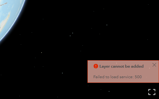

After few seconds to upload and puplish, I got a Error like " There´s a error" and it´s impossible to publish and use the project.
I tried the same steps on ArcGIS Pro and got the same error.
My slpk works perfectly on AGOL, but it´s not a option here .
Logs from ArcGIS Server after try
LevelTimeMessageSource
SEVEREMar 8, 2018, 1:49:36 PMError executing tool. Publish Portal Service Job ID: j569ae00ab9114e17b08513f30cfedf36 : ERROR 001887: Failed to create couchdb database. ERROR: no registered nosql databases on the server. Failed to execute (Publish Portal Service).System/PublishingTools.GPServer
SEVEREMar 8, 2018, 1:49:36 PMERROR: no registered nosql databases on the server.System/PublishingTools.GPServer
SEVEREMar 8, 2018, 1:49:36 PMFailed to create couchdb database.System/PublishingTools.GPServer
