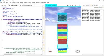

Hello everyone. Is there a way to get the sum of the numbers generated by the division command using split.index? For example, we have a 5-story building and if we use the split.index command, the floors start from zero and finally the 5th floor receives the number 4 and the sum is 10, that is, 0+1+2+3+4 = 10

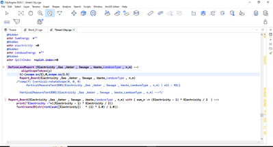

maziaryousefi
Thanks for your answer - I want to get the total electricity consumption of the floors and then display it in the report panel at the top of the building. I used the same method as you but it gives the wrong result. I think I need to find a way to associate the amount of electricity consumed by each floor with numerical indices split.index via the set command. If you have any ideas on this, I would be happy to hear it.
