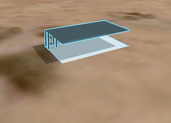

Hi everyone 👋
I am working on creating a Carport CGA rule in City Engine. The carprt looks like a table, please assist with this cga rule for, I would like to have the roof sit on the poles and not be displaced like that.
Here’s what I’ve done so far:

Hi @TidimaloMaphoto ,
I took a different approach, created two branches. One for the roof and one for the poles and worked independently.
version "2024.1"
attr poleWidth = 0.5
attr carportHeight = 10
attr slabHeight = 1
attr carportColor = "#313333"
scale_on_X = scope.sx - 2 * poleWidth
scale_on_Z = scope.sz - 2 * poleWidth
plot -->
	color(carportColor)
	Poles
	Roof
Poles -->
	s( scale_on_X , '1, scale_on_Z )
	center(xz)
	extrude(carportHeight)
	comp(e){vertical: Edge}
Edge -->
	center(xz)
	rotateScope(90,90,0)
	primitiveCylinder(12, poleWidth, carportHeight)
Roof -->
	comp(f){top: Slab}
Slab -->
	extrude(slabHeight)
Check if that is what you were trying to do.

TidimaloMaphoto
Thank you so much @plfontes .
I adjusted a few parameters and the shape came out perfectly.
