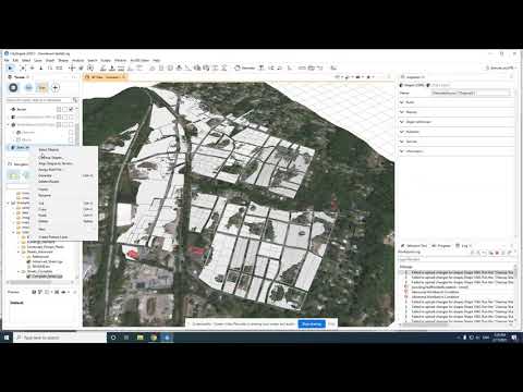

https://youtu.be/sYipP67-Oqs
Followup video showing issue repetition
