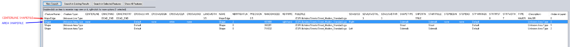

1) When I export this network as a graph object (line/centerline shapefile):

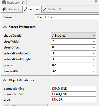

I lose attributes that are applied in cga rule:
And only the Object Attributes and Segment parameters are written:

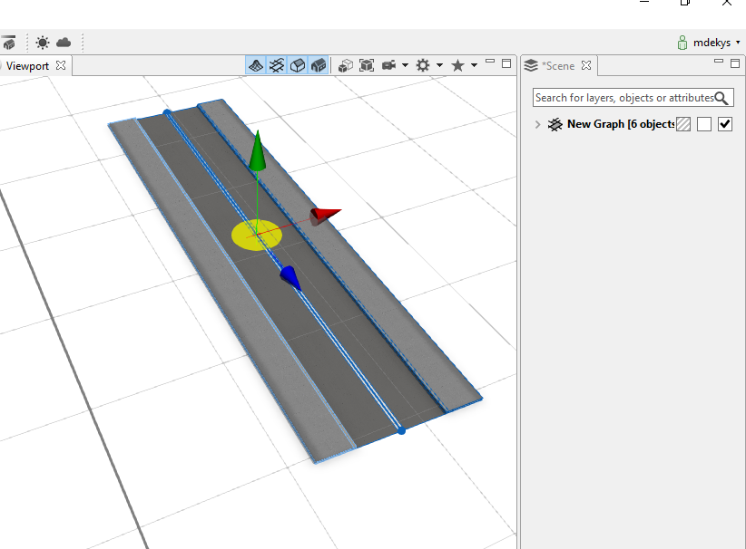

2) However, when I export this graph as a shape (area shapefile):
all the cga rule attributes are written as shapefile attributes - but this exports roads footprints (areas) instead of lines (centerlines) which I want (for traffic navigation) as shown on the following image:

This is expected behavior.  When exporting the graph network, only the nodes and edges of the graph are exported.  Then, shapes for the streets, sidewalks, crossings, roundabouts, etc are generated dynamically from this graph.  Rules are applied to shapes (and not graphs), so when a rule is applied to a street shape, the rule attributes are associated with the street shape.  That's why exporting the street shapes gives you the rule attributes.  Rules and rule attributes do not belong to graphs, so that's why they are not exported.
