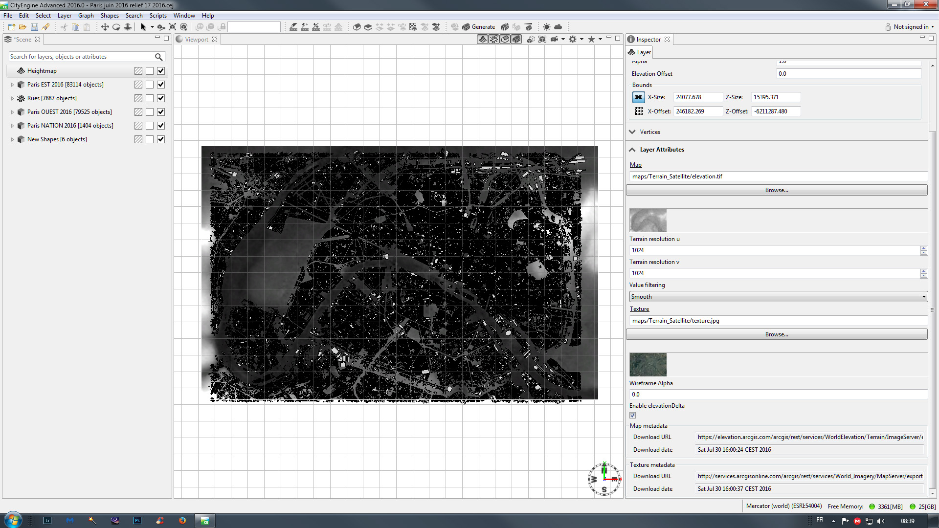

Hello,
I try to emphasize urban construction, to provide "elevation" with a layer "terrain" called "hightmap".
There is something that escapes me totalement.With older versions of CityEngine, I succeeded without problems.
With the 2016, I have to miss an obvious manipulation and I turn around ...
I can not find the line:
attr = elevation map_01 (brightness, 0.0, 150.0) ...
hightmap layer in the window "inspector" ...
My image "elevation.tif" of "layer attributes" remains flat in the 3D view
I and I not manage to "align graph to terrain" ...
I know it must be simple. I looked ten times the tutorial videos and examples ...
I realized without problems in earlier versions of CityEngine ...
Can you help me find what I do not, I do not see ...
Thank you and good day
PS: the new version of your forum is much more confusing than the old.
It's very difficult to navigate ...

There have been no changes in that section of the Inspector. So you were looking in the right place.
For some reason the last part with the layer attributes is missing on your screenshot.
Please try to re-open the scene and check again.

I even start a blank project much smaller in case ...
But the same ... The inspector does not release the code lineesri 2.jpg.

It looks like the Heightmap and Texture files have been successfully downloaded.
But clearly the terrain layers elevation attribute has has not been set.
Could you please try to add the Heightmap manually by navigating to
maps/Terrain_Satellite4/elevation.tif
and right-click to import. As shown below, you can manually set the elevation attribute.
I hope this will provide a solution.

So I followed your advice and manually entered values in the "terrain"
Nothing changes. No additional command line does not appear in the inspector and geometry remains flat.
On the other hand, I just noticed the absence of the "texture" on geometry
Only the "hightmap" black and white displays in the project.
