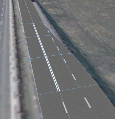

I encountered a problem while creating roads based on a OSM file - one segment of the highway is described as 3 lane, while two adjacent are 2 lane. The result is this weird joint between them:

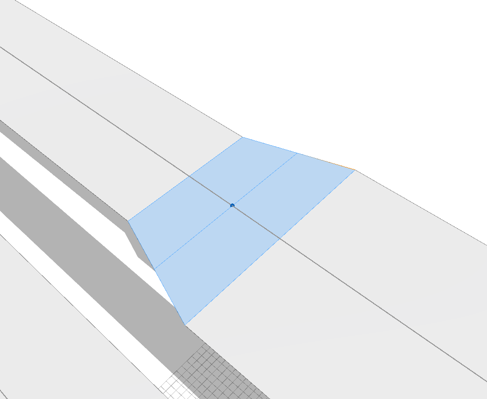

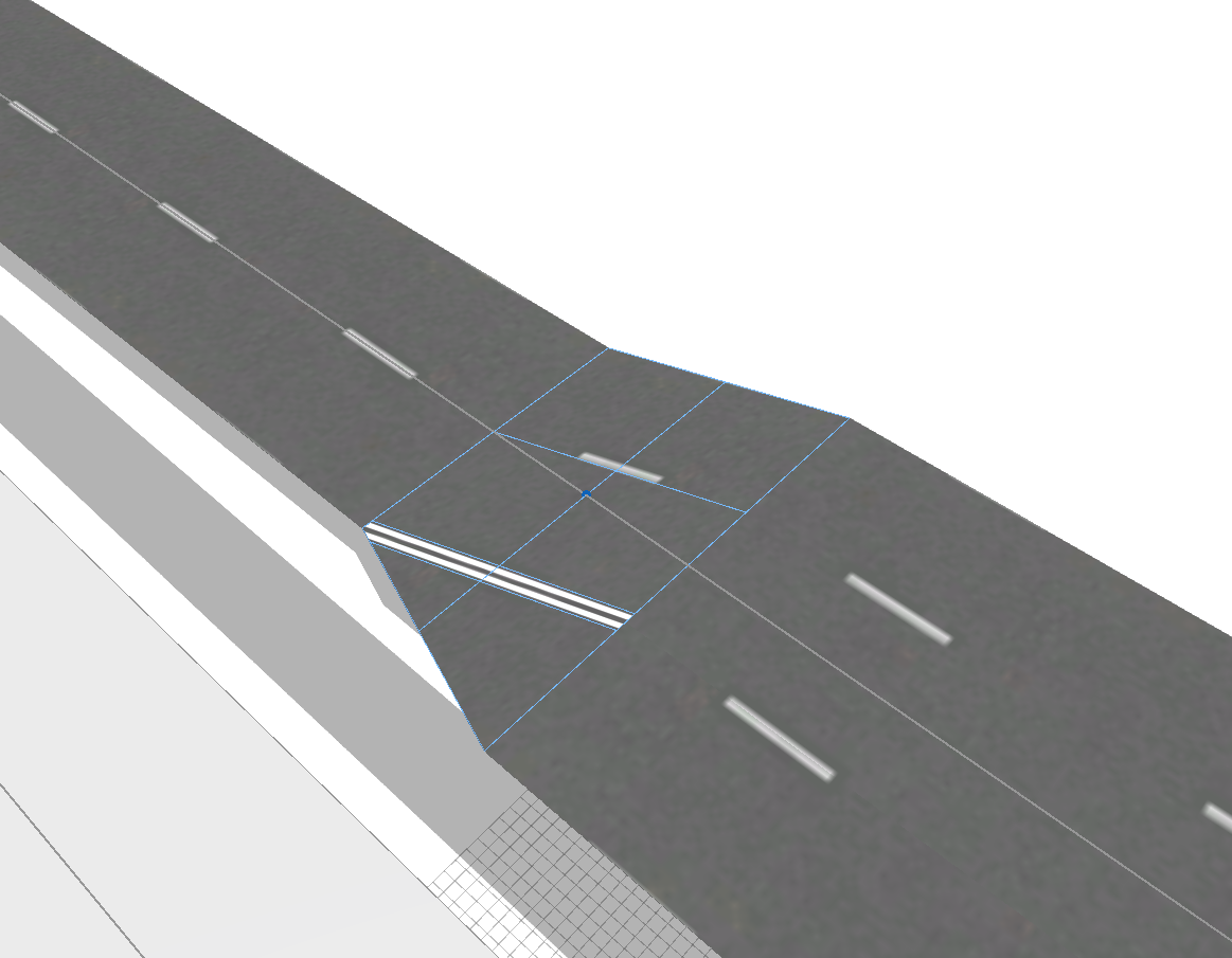

Well - the answer is using the "streetOffset" parameter and increasing the minArcRadius on the "Joint" shape, giving the results as on the screenshot. Lines are incorrect, but I imagine it will be a simple fix in the rules file.
I encountered also a similar problem on freeway exits, but it was sufficient to change the nodes "Smart" option into "Junction" or "Freeway" and work from there.
