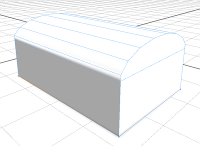

How to create a hangar-type roof for buildings in CityEngine?
It is not built-in to primitive roof types, so do I have to start with rotating and splitting a cylinder?
Tags (2)
CherylLau
Here is some code that does what you suggested (rotate and split a cylinder).  It assumes the building footprint is rectangular.

Lot -->
	extrude(eave_height) Mass.
	comp(f) { top: HangarRoof }
HangarRoof -->
	alignScopeToGeometry(zUp, any, longest)
	rotateScope(0, 0, 90)
	primitiveCylinder(2*num_hangar_divisions)
	s('1, '1, 2*roof_height)
	t(0, 0, '-0.5)
	split(z) { ~1: NIL | ~1: HangarRoof. }
