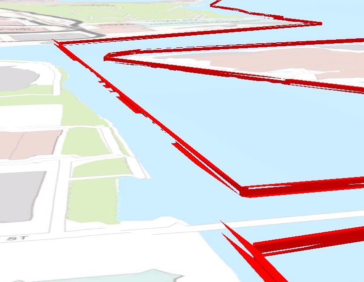

So, I have a polygon shapefile in CityEngine and I want it to be a thin 3D outline with no color infill. I tried doing it in ArcGIS Pro by setting the symbology properties and extruding. I do not like the way it looks see image...Boundary.JPG

However, when assigning the dashed boundary rule to an irregular shapefile, it causes a big long crash to any computer. If I draw a perfect rectangle, the rule works perfectly. But, on the complex and irregular shapes there is a big problem. I tried to increase the  corner scale to 5 meters, but  it still crashed when applied to my district's political boundary.

     For instance, the same rule applied to the shapefile looks different in some areas and corners.
        Good                                                  Bad                                                   Ugly

I did know that sharp corners would possibly break it. I'd have to see the project and shapes in question to help trouble shoot. I'm a bit knee deep this morning, but if you can't fix it, try posting a stripped out version of the project, so that we can see and test on the same shapes you are using (scene, rules, assets).
