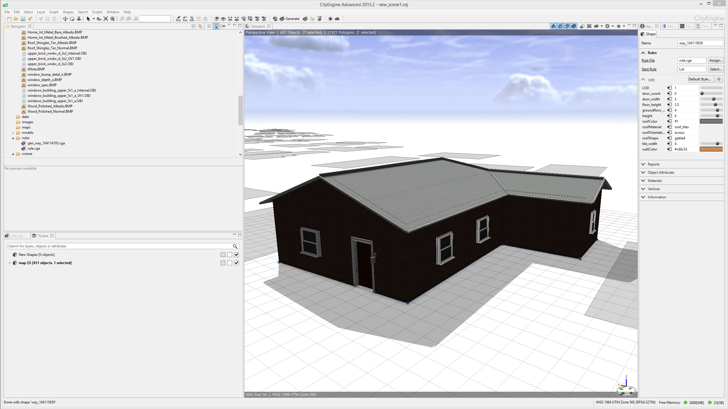

I want to randomly split up the house into several rooms and also the interior walls need different texturing.
There is the outside:

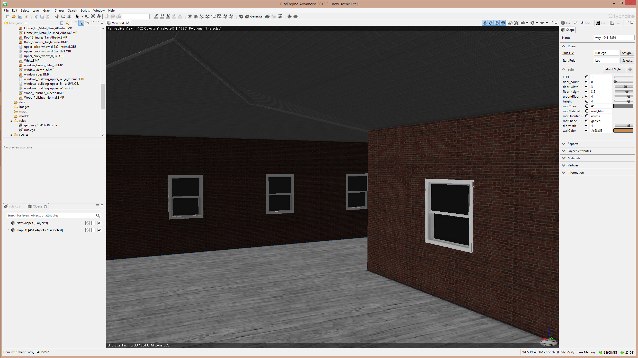

And the inside shares the same texture and no ceiling!

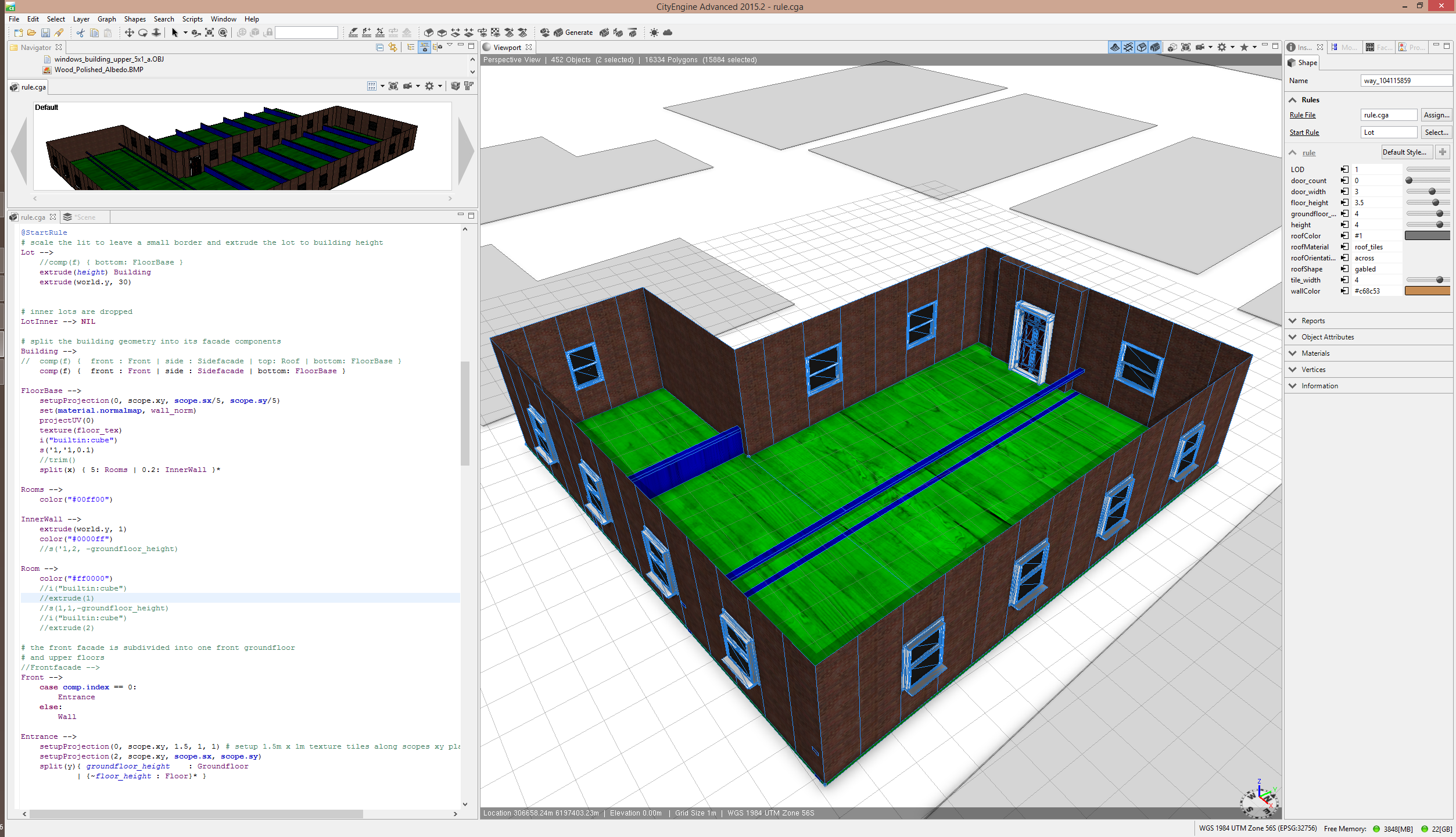

I tried making a split but cannot extrude an edge upwards to make partitions:
FloorBase -->
  setupProjection(0, scope.xy, scope.sx/5, scope.sy/5)
  set(material.normalmap, wall_norm)
    projectUV(0)
  texture(floor_tex)
  split(x) { 5: Rooms }*
Rooms -->
  color("#00ff00")
  comp(e) { 0: Room }
  extrude(1) Room
Room -->
  color("#ff0000")
I have tried to extrude and scale but get these weird issues:

I am now trying to get random bedrooms inside any given shape. I am using touches() so if a wall touches a window then window is replaced by wall. Not sure how to randomly generate partitions however.
I have this that will create 4 divisions along the y axis but for large or small this won't work:
split(y) { '0.25: RoomsFloor | 0.2: InnerWall }*
I need a way of finding the area or length and then doing an appropriate split condition.
