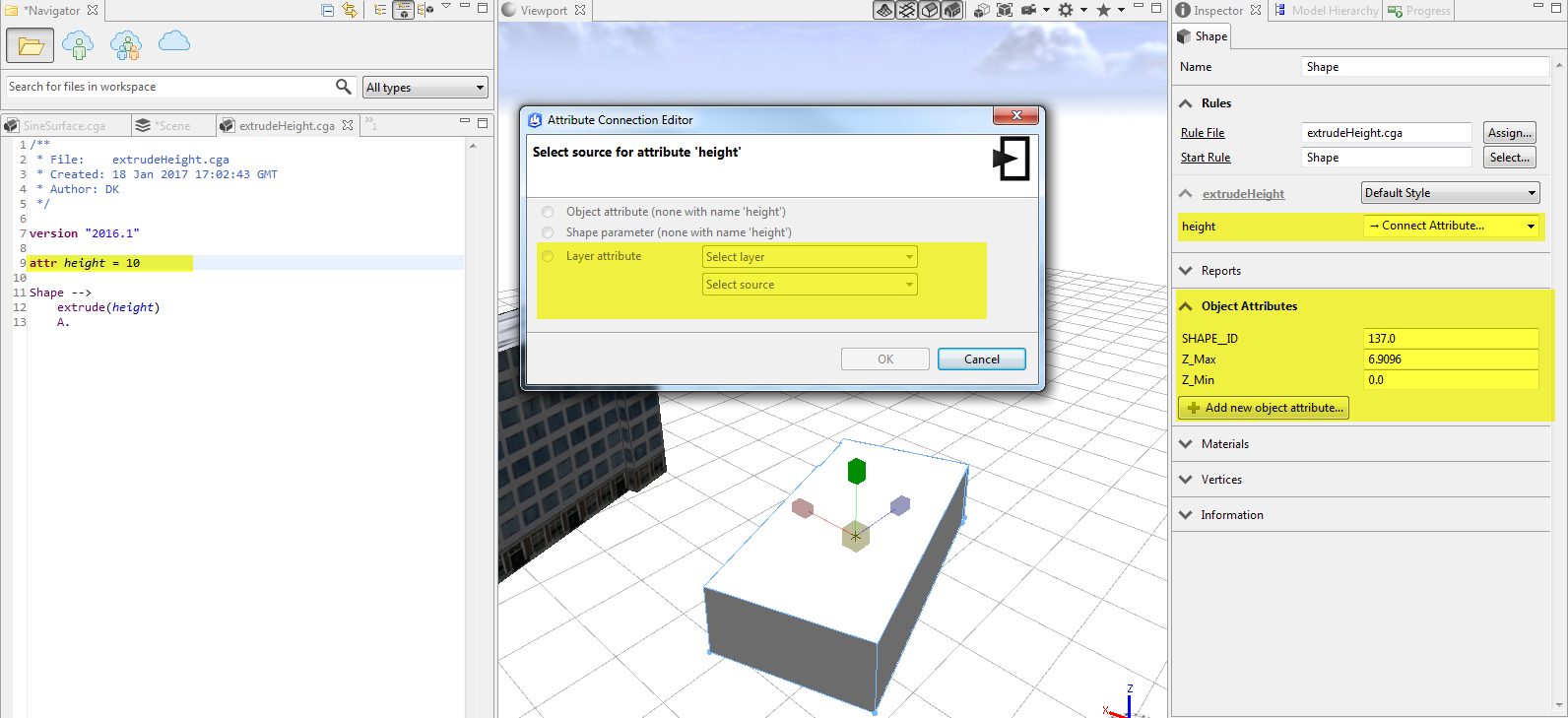

I'm using 2016.1 and when I try to connect an attribute to my rule file, I am unable to make the connection unless my parameter has an identical name to the attribute that I am trying to map. From my understanding, I should be able to select any alternate layer and attribute name and map it to my shape. Does anybody know why this is happening, or how to get around this issue? Is this a bug? See images attached:
Here I'm creating a basic extrusion with attr height, and I want to connect attribute Z_Max, but I don't have the ability to do so:

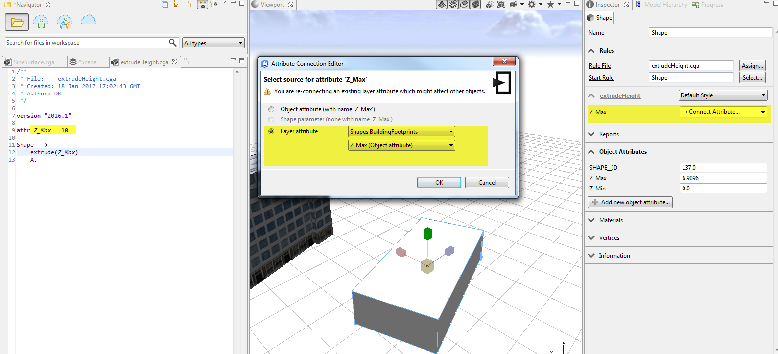

I've now changed my rule file to name the attribute Z_Max, which matches my object attribute that I've imported in the shapefile. Now I have the ability to map Z_Max, as well as any other attribute that's available in my scene.

Here I have attr height with no height object attribute, so the connection editor is disabled.
I clicked the "add new object attribute" button and added value "height" with a 0 value. Then I was able to open the connection editor and map my layer to the proper height layer, Z_Max.
It just doesn't make sense that a connection editor can only become enabled if it detects a matching object attribute, even if that object attribute isn't the one that actually needs to be mapped. It creates a lot of issues if we are trying to create user-friendly CGA scripts. If I make a "universal" script to extrude building heights, I would expect that a user could choose to make a connection to their own height feature attribute, whether the attribute is called "height", "HEIGHT", "bldgHeight", etc... The user shouldn't need to go into the CGA and manually update the code to work with their own imported features.
