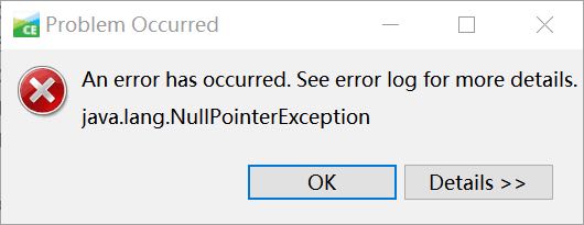

a few days ago,i was still using cityengine and nothing problem occurred.
but now When I open the city engine ,it quit unexpectedly with nothing ,I have installed version2016,2018,2019,they both have this question ,when I open the version2016 and click the scene window, it shows like the picture ,how could I solve this problem?
Thanks a lot

Hi
Thanks for reporting this issue
Could you please provide, the information that comes up when you press the Details>> button?
If CityEngine doesn't start correctly, you can try the following:
  1. deleting the user preferences folder in your user account (on Windows C:\Users\<user>\.CityEngine\20XX.XR.win32.win32.x86_64)
    -> This will reset all user information (like Workspace settings, user accounts, ...)
  2. If you are using the "Default Workspace", rename the folder  (on Windows C:\Users\<user>\Documents\CityEngine\Default Workspace)
    You can later switch back to the renamed workspace or import your projects from there.
