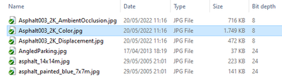

The rule uses a texture with an 8-bit greyscale encoding that is not supported by the SLPK exporter:
/Complete_Street_Rule-2.9.0/assets/Complete_Streets/Lanes/Asphalt003_2K_Color.jpg
Please use an image editing tool like MS Paint to save it as a 24-bit color image.
TelmaFernandes2
Thank you Thomas, it worked!!
