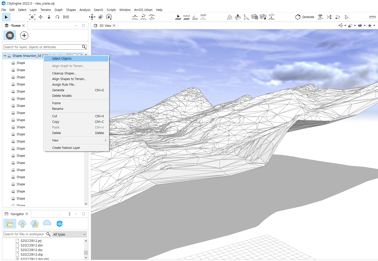

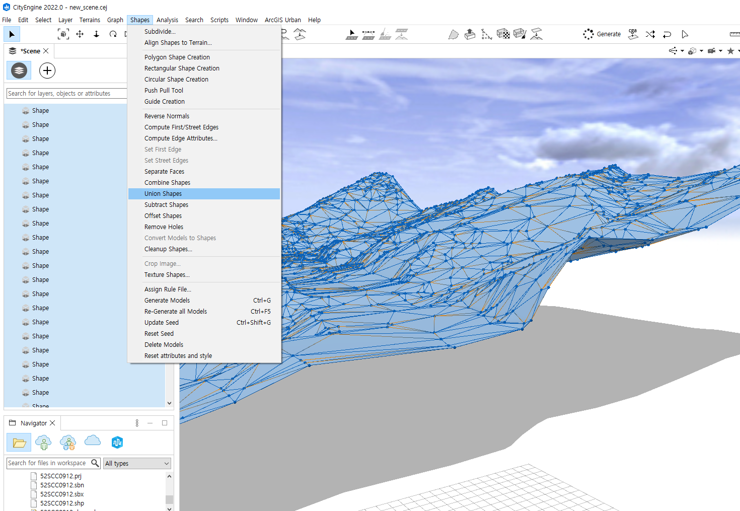

I am curious about the script that sequentially loads multiple shp files in the folder, selects the upper layer as shown in picture 1, selects "selet objects", accesses the top menu "Shapes" as shown in picture 2, and executes "union shapes"

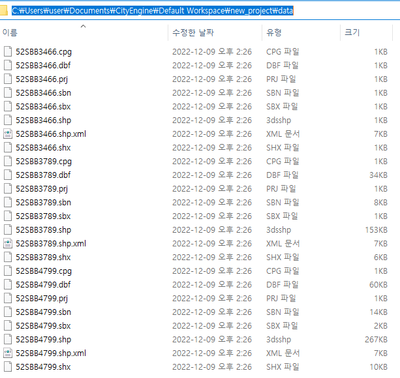

First of all, thank you very much for your answer. If there are shp files in the path of the attached picture, how should the script be written?

hoya
First of all, thank you very much for your answer. I ran the script, but only the first file is loaded in "3D View" and "Select Object" and "Combined Shape" do not work. Attached is the shp file I'm working on.

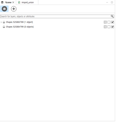

hoya
First of all thank you so much for your reply. However, when I run the current script, the modeling is configured the same as in "Picture 1", and "CityEngnie" continues to work and the script does not end. But what I want is to run "select objects"->"union shapes" for each modeling like "Picture 2".

plfontes
Hi @hoya ,
I believe there is an issues with one of your SHP files, as I mentioned before. The script gets stuck trying to union the imported shapes, which may be an indicative of problems with the geometries. Can you load the files individually without any problem?

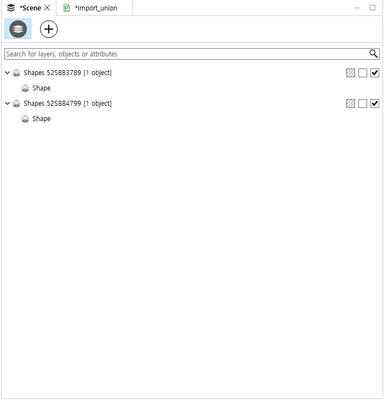

hoya
Thank you so much for replying first.
I deleted the "shp" identified as the problem and ran the script again, but the same problem as before occurs. If I do it manually without using a script, it runs without problems, but I have to run it as a script because I need to run a lot of files. Edit the file again and attach it. Check it out.
